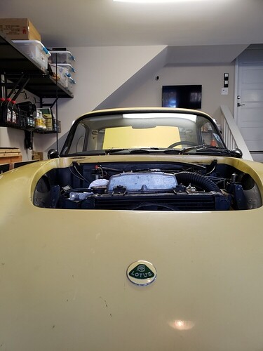

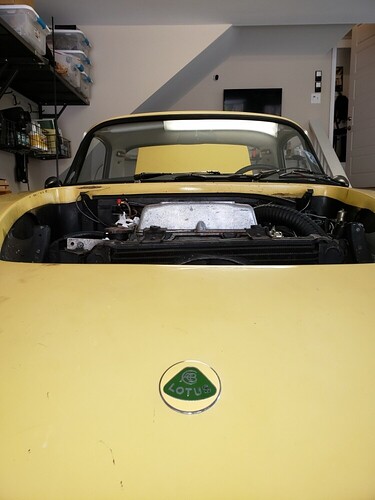

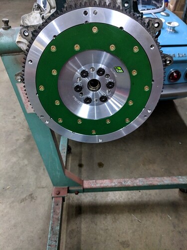

Finished replacing my motor mounts, with visible results:
Pulled the engine for a reason(s)
Going back to an aluminum fly wheel (but not race weight and minus the tilton clutch)- also going back to an airbox -
more to follow.

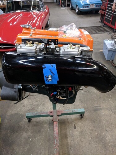

Who made the air box?
V ,
It’s the TTR Air-Box - its much larger at the back vs the stock item . Inlet is also larger ( 4.0 vs 3.5" ) .
Thank you, it looks much larger than one I bought years ago from TTR.
V

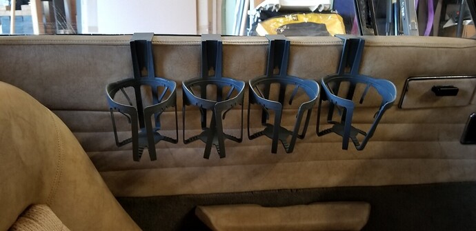

I “Federalized” my plus two…
(Really I did this yesterday and just went for a drive today :slight_smile: )
AWESOME! (As we say in The States :mrgreen: )
While not wishing to cast aspertions on the cousins you cannot be driving your Elan properly unless the cupholders are only there to hold the empty beverage container.
Richard- He’s putting you on. In Texas they drive with the beverage tucked firmly between their legs. Wow, talk about thread drift. :smiley:
Sorry, I didn’t realise he was in Texas. So, if he is in Texas, where does he put the handgun? (I presume the rifle will be on the gun rack|)
It’s Texas, so I start with them full, by the time I get to a Lotus suitable road they’re all empty!
No gun in the lotus, would just be added weight which isn’t needed with the handling and standard fitment oil slick feature aiding any required escape.

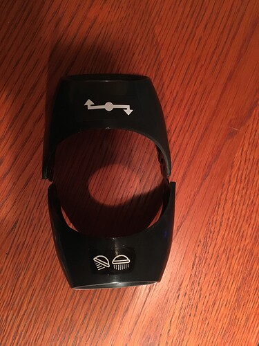

Applied new (correct LHD) stickers/transfers to my steering column binnacles

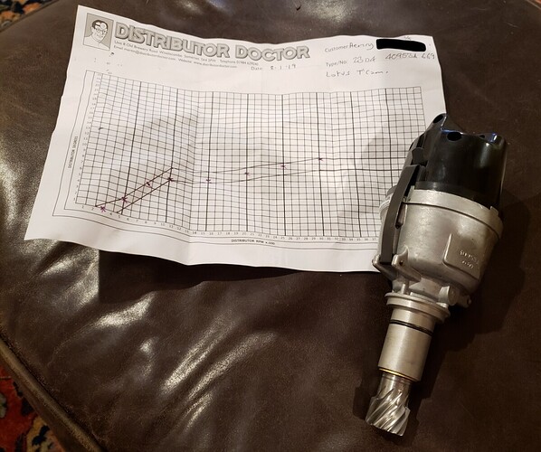

Mine came in a slightly smaller box, but my “new” 23D4 arrived today from the distributor doctor, along with parts for rebuilding my existing.
