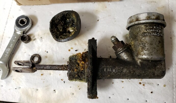

Finally got around to pulling my leaking clutch slave cylinder, circlip was a pain and the cylinder fairly stuck in the housing, but finally got it. Debated long and hard about the master cylinder, finally decided to screw myself under the dash to get to the bolts - I think I need to do yoga to figure out a better way in. Glad I did, though - it’s a wonder I had any clutch at all.

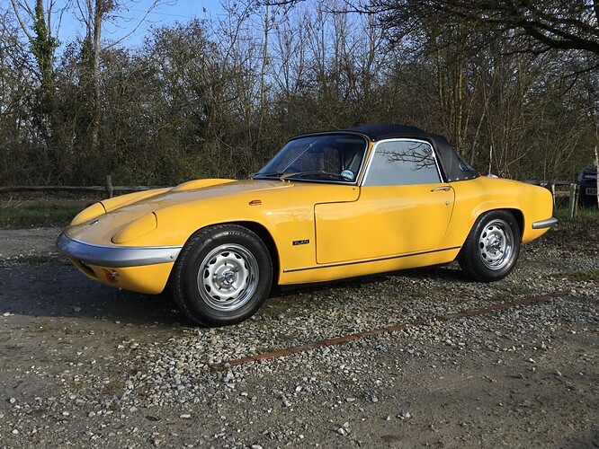

Despite having had a light dusting of snow last night I decided to take my Elan S4 SE for a drive to Sissinghurst Castle near Cranbrook Kent for a Birthday treat this morning. Not my Birthday but the cars. 50 years to the day my Lotus Elan was first registered to a Mr C Castle the car being supplied in kit form by Manchester Dealer Sports Motors Ltd. The car never fails to put a smile on my face and is at its best on the B roads around Kent and Sussex. I wonder where the Elan will be in another 50 years if it survives one things for sure I won?t be around.

Clutch slave cylinder- seal gone, has lasted about ten years iirc.
In order to drive up the ramps, one needs to have a working clutch! I did a quick and dirty bleed-job to get something like half a pedal and managed to get it up in the air.

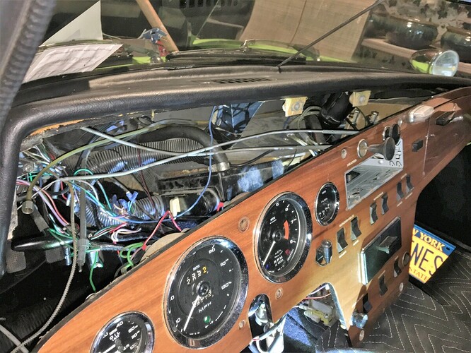

The heater is in…
Looks good Phil… Try to position the clamp for “easy” access in the future, if need be, like through the
radio opening or some gauge opening.

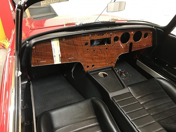

Phil - Snap, well almost. The dash is just a trial fitting.

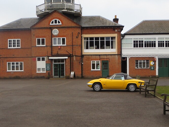

Took my S4 on a run to Brooklands Museum to celebrate the 50th anniversary of it leaving the Factory on Feb 5th 1969.
