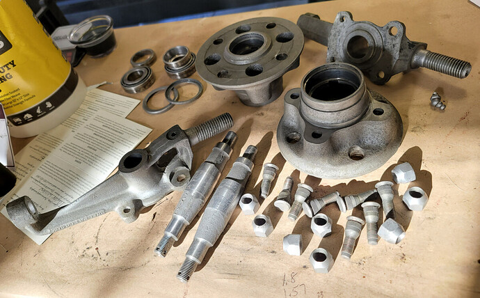

A wet morning unfit for much, so spent some time cleaning up hubs, axles, and uprights before putting them away for a future project. Always rewarding to get old rusty bits looking the part again.
