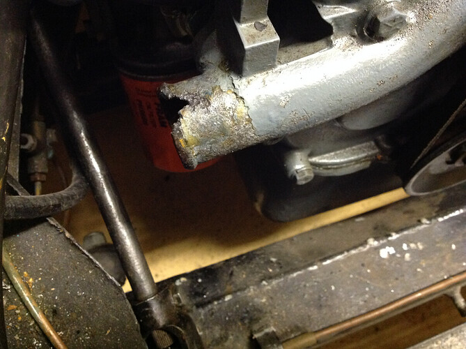

Removed the radiator to carry out a simple task on the right hand bracket work … And opened up a can of worms ![]()
I feel some questions to the tech forums coming on.

Ouch, that is a seriously corroded front cover!
Perfect job for JB Weld no problem.
If you JB weld, I would add an inner sleeve first. Clean the inside of your output, add some JB to the outside of the sleeve and inside of output after you sand/scuff matting surfaces. Also clean up the sharp edges of the pump output.
I’m guessing that’s not the only corroded part, but if it is, I’d try Alumaloy or an equivalent alloy brazing product over JB Weld. I’m also guessing the JB Weld suggestion was in jest. ![]()

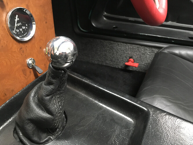

All of my ‘old’ cars get a battery disconnect, mounted to be accessible from the drivers seat. And I always turn them to off when exiting the car.
Here’s the one in my S1, with removable lever for additional security.

I really want to install one of these. Due to the relatively tight battery spot, the normal switches I use don’t fit comfortably.
