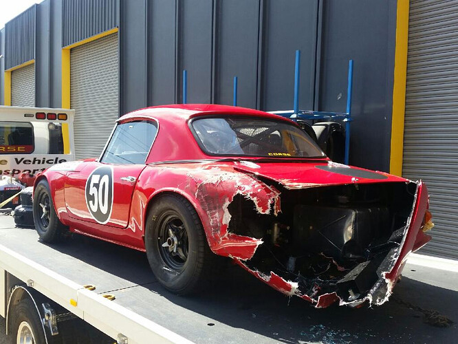

The 26R shell was supplied by TTR, as was the red one in the background, on both counts very happy with them.
I’m just under 6’5", so the roll cage was custom built here in Sydney by a chap who makes cages and chassis for Dakar, rally and the highest level drift cars. This is the second cage with further improvements to give me more space and add cross bar that connects to the bolts that are behind the centre of dashboard, and also has mounts to fit the steering column and keep the front legs apart in event of a side impact. Both were custom fitted to the shells and chassis. I’ve been in a 190KPH rear impact with concrete wall in the red shell, the cage limited the damage rear section, with the cockpit, doors opening and closing and the roof undamaged. The worst damage to the shell was restricted to the boot area which was shattered up to back of the boot lid, this was cut off and replaced locally.

Thanks for replying vaughan, I’m sorry to see the 26R damaged, I hope you were alright, looks pretty nasty.

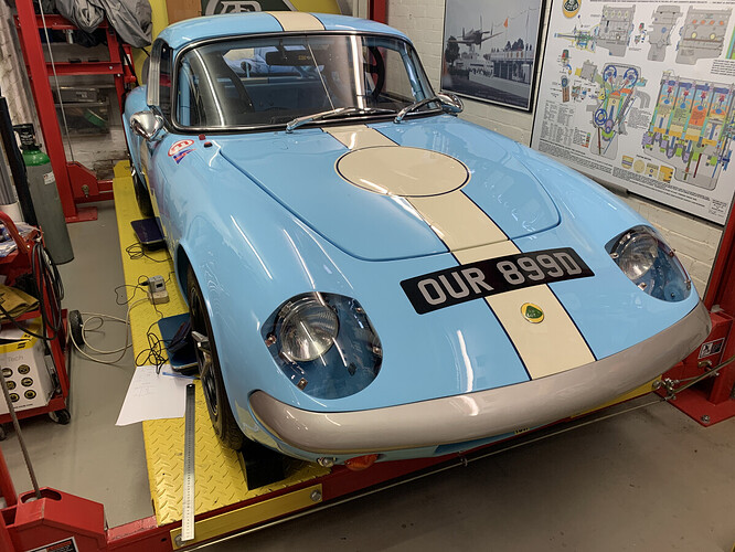

Started to corner weight the car on four ebay 300kg scales.
What a dog’s dinner.
Will take it to the professionals!
What did you find the most challenging?
I will be doing mine, on my stationary alignment rack this week or next.
As per the PM to you, the scales were ultimately not of a quality that could be relied on. 2 of the them bowed in the middle ( therefore the wheel was at a lower height) and one scale split, so lower and of questionable reading.

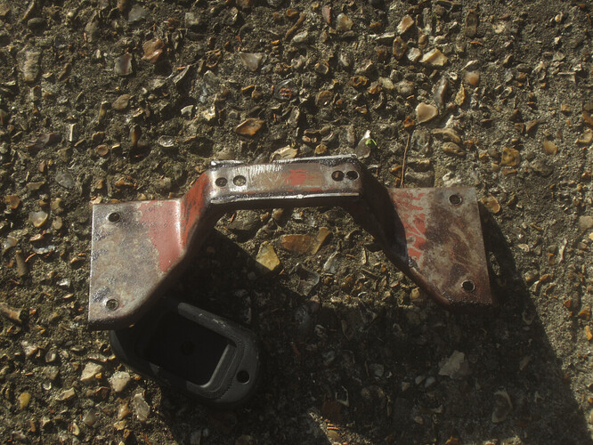

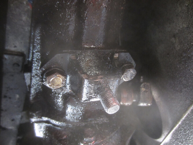

Finally completed my Gearbox mount replacement. The support had been modified, presumably in the 70s during a chassis change, to take the later rubber unit and I had to return to St Wilkins to change type.
The spacer on the gearbox had a 7/16" stud instead of 3/8" so I had to ream that out and then struggled to line up the support bracket with the chassis, but won.
Having sealed up all the exhaust holes I could find I was disappointed when the car still sounded coarse, like the engine had no rubber isolation, and found that the RH engine mount had also failed!
I jacked up the engine and stuffed a cut-down front suspension rubber into the top of the mount and that did the trick. With the rattles in the passenger door suppressed (by tightening all its panel attachment screws!) the car sounds and drives like new and the gear box and clutch work more smoothly. At last!
