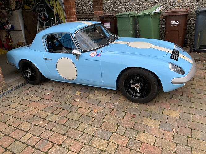

She drove for the first time since 1983
full of noise and very frisky
Good news 661 :smiley:
Superb!

Graeme, Brings back memories of when we finished my 26R, that first drive for me was worth all the years waiting to find one and the hard reservation yards!!!
Looks awesome, its a credit to you mate, have fun

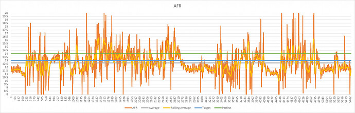

I drove the car with app logging data (via usb-c to DB9 convertor) from AEM gauge:
Doesn’t look too bad but need to do better job of driving certain test cases and isolating the data so I can better look at any changes needed.
There probably a little room to go leaner on both main jets and idle jets. (Idle is set up for ~12AFR).
“I drove the car with app logging data (via usb-c to DB9 convertor) from AEM gauge:”
Good grief man !! What are you doing? This a Lotus forum not something about space shuttles!!
What sort of motor car do have to abuse it in this way? :unamused: :unamused:
PS - I have just fitted famous Franks NF tubes and you would not believe the improvement in performance…:open_mouth: :open_mouth:
Lol. I wouldn’t call a 9600bps rs232 connection rocket science. The technology is older than the car!
As far as I know it’s just a standard big valve engine. I have an older Kieth setup on the car that I am trying to dial in. Moving from 125 to 115 main jets made the car feel like a rocket at higher revs. I think there probably some room for improvement left but is quite good as it is.

Running Keiths NF tubes I have this jetting with 420 cams.
34mm choke - 140 Main - 200 Air corrector, NF emulsion tubes - idle jet 45F8
And it is going like a greased weasel…:laughing:
