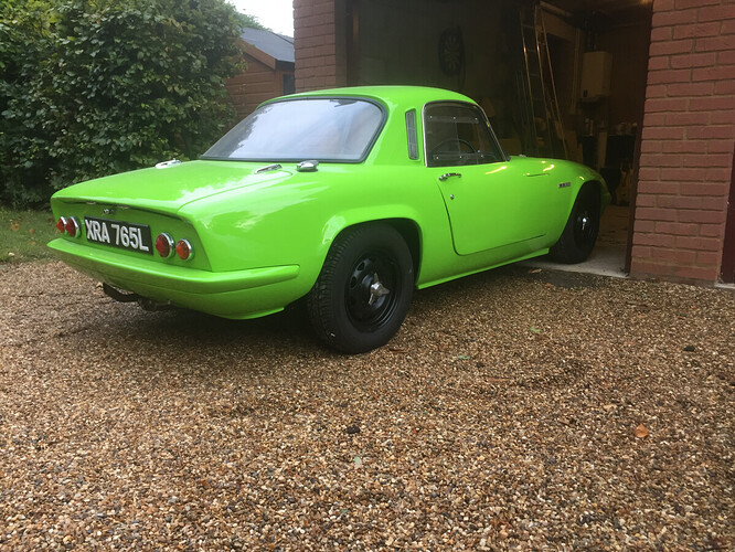

Finally have the Plus 2 back on the road after getting transmission difficulties sorted. Washing her up today and meeting with a few local Lotus enthusiasts in a socially distanced get together. Hard to believe, but I actually don’t seem to have any fluid leaks!

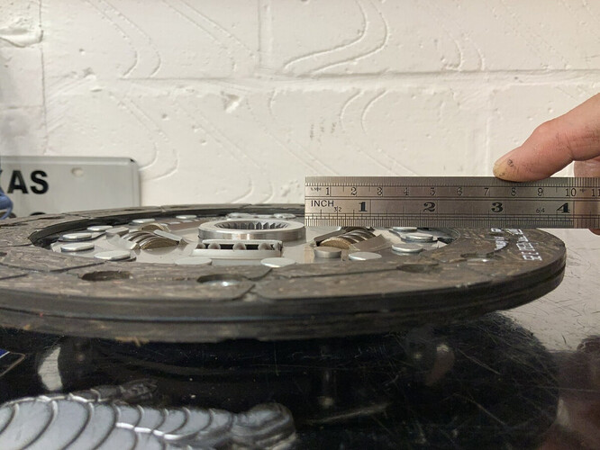

Got a shiner new 5 speed clutch from QED. Also note that the flywheel side looks to be already machined.

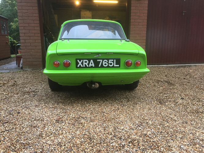

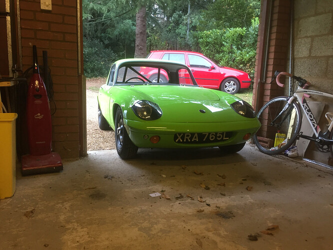

Today was the first time in 12 years that the car got out the garage under its own steam and did a quick trip round the block :mrgreen:
Everything seems to work :unamused:
I started it a few weeks ago when it was on axle stands and was amazed that it started after a coupe of turns (having checked oil pressure without plugs first and using a boot primer for the fuel pump)
I will regret saying this but I only have the windscreen to fit and the rear screen seal.
The clutch works fine, wasn’t stuck to flywheel, but the biting point is quite low - is that normal.
At first there was a rubbing/squeaking noise from the front of the engine but it stopped when the engine warmed up - perhaps water pump bearing having been dry for 12 years ?
The steel wheels are poor but will be replaced with some revolutions from Kelvedon motors when they get some in.

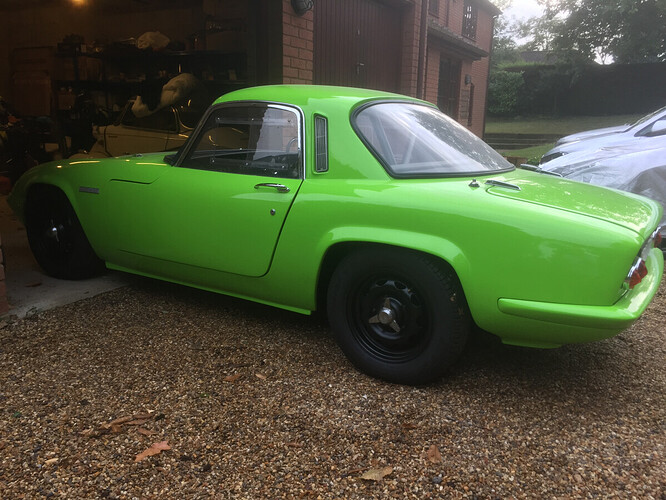

Few pics below
Well done - get some autumn miles in!
Well done in getting another resurrected. Love the colour
Agree with Mark time to enjoy the autumn sun…

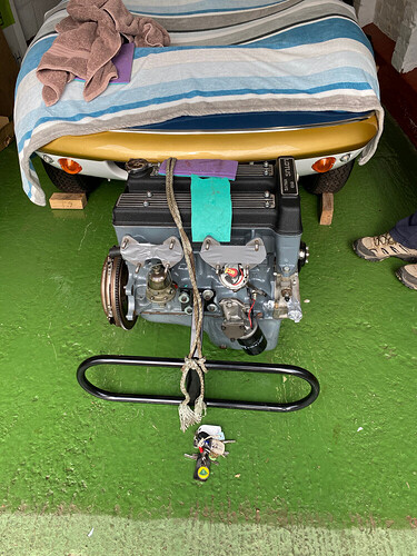

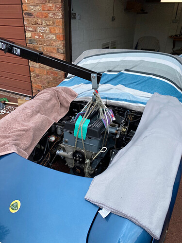

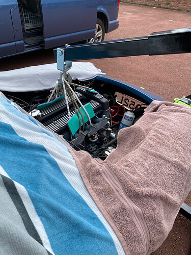

Engine out day…
Lifted from the side as suggested by MikeD.

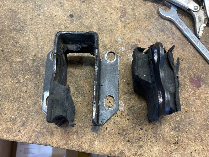

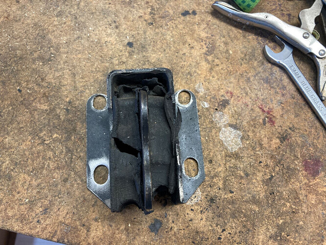

Coming back from our last road trip, to Eureka Springs, AR, I noticed at one point that the engine felt a bit harsher, and there were dash/console vibrations that weren’t there before.
When we got home, I check the car out and found that the bottom of the exhaust header seemed to be touching, or very nearly touching, the cross member. It looked like the engine mount had slipped down a bit where it’s attached to the chassis.
So I put a jack under the engine, and repositioned the mount. When I lowered the jack, the engine went right back where it was. On closer inspection, it was clear the engine mount had failed. I guess the exhaust heat, over time, just got to it and it gave up. There was metal on metal contact in the mount that was transmitting vibration through the chassis.
So today’s project was to replace it. I got it off ok, but, and I’m still a bit confused about this - I needed more room on that side to get the new one on. So I pulled off the starter and the right side mount, and pushed the engine over about an inch, and got the room I needed. I’m getting pretty good at getting the starter on/off!

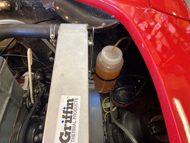

While I was at it, I converted to a washer bottle, from the bag that was used on the Sprint. Much easier to tell that you’re low on fluid now.

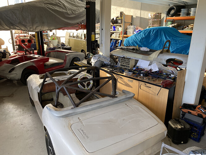

I’ve been busy over the past week collecting my Loti, now all back under the one roof at the Shed and now its time to get into them again. With 26R S2 in foreground, S2 repaired 26R shell and S1 Shapecraft under the cover… next step is to drill all the holes on the 26R shell and get to out for paint using the S2 as the reference, then its off to be painted a pale Lotus Blue and then into final assembly with 1760TC, semi close etc.
