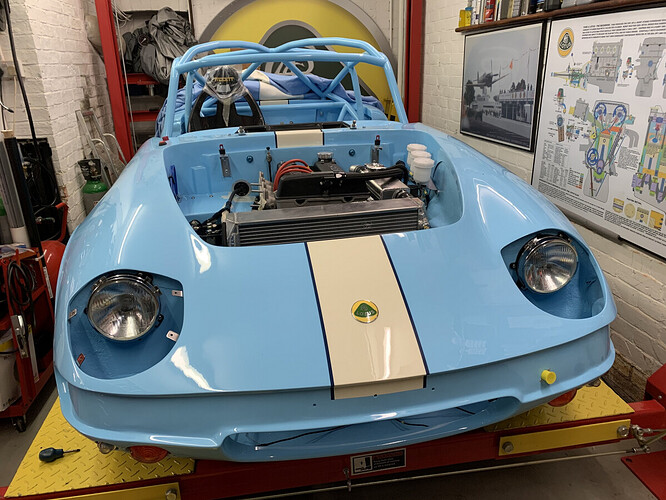

I’ve been busy lately, today I made up the 3/16 brake lines for S2 project I’m working on, last week I collect S1 and 26R and next week I’ve got to collect the shell for the S2 which will be using my repaired 26R shell, all it took was a new rear from turrets back, new passenger side front qtr and sill and a few $$. Les is the artisan who repaired the shell, as always he did a fabulous job, with post repair shell weighing only a few kg’s heavier than pre accident.
As its using a TTR super lightweight chinese eye shell, I’ve decided to build S2 with pared back interior, san’s windscreen wipers, heater and frame/windscreen cutdown to 6", aka the 356 speedster thinking, less is more. Les is working on new screen frame and we’ve already made a mould for the Lexan screen which will be bonded to the frame with drop in or fixed cut down side windows and a dash top that flows around into the doors. Toying with alloy detailing for doors, dash.
The objective is to make the changes without messing with the underlying car, so that if desired it ca be returned to OEM spec, with screen etc.
Mechanically it will have an 1860 TC, CR box, 3.77 final drive, LSD, adjustable shocks and spring towers, 130-150lb front and 100-120lb rear springs with 6 or possibly staggered 6 and 7x13 Minilights.

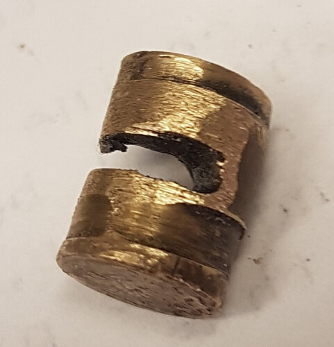

Something I have had in mind for a long time. :bulb:
Purchased 100mmx3/16" brass rod £3,35 on e bay drilled and cut a new accelerator barrel for the Weber linkage, makes a smoother acceleration :slight_smile:

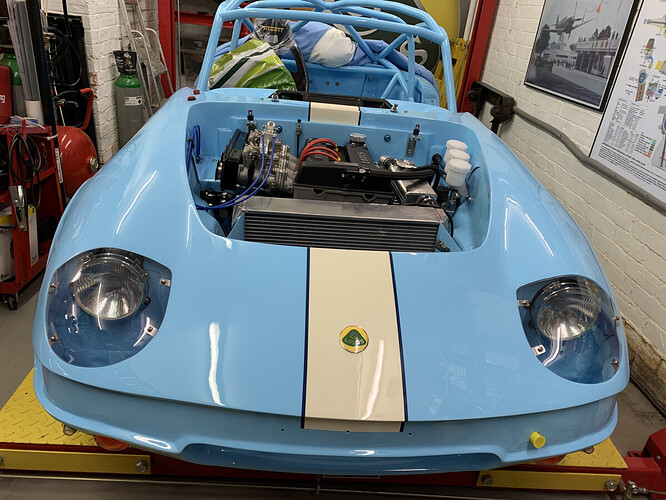

Stuck a few more bits on
…and a few more bits
