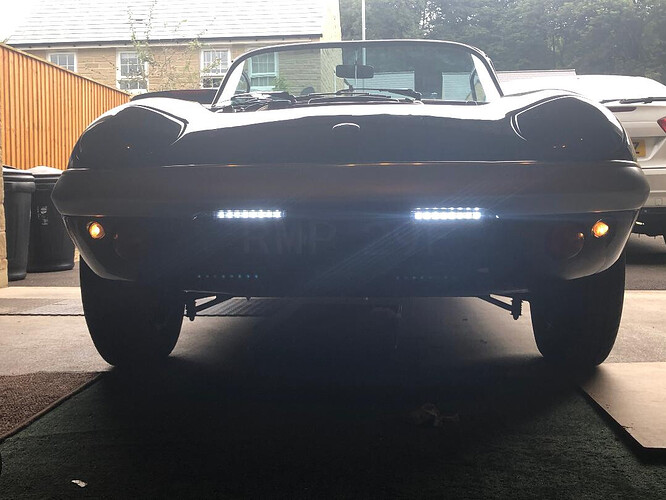

Just part way through sticking some DRL behind the grill to aid being seen by the SUV brigade… Currently rigged to the side lamps until I get a dimming unit fitted… See if they make any difference :unamused:

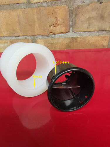

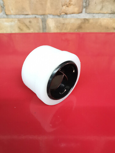

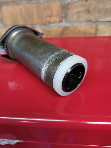

This was after I finally got round to machining an adapter to take the MX5 one way valve.
Difficult to see in the photo, but in the adapter there is a groove, this is to secure the MX5 one way valve to click in with its 3 ears.
The adapter is a slight drive fit in the Original fuel fillet tube.
Do you have the capacity to supply these please
Sorry no.
The difficulty is getting the MX5 non return valve.
I was lucky in that I got mine off a forum member who had a spare one.
That forum member is the original poster of this topic.

Mr Bonus - One thing you can do as mentioned elsewhere is fit LED bulbs all round and LED driving lights behind the grill. Makes a great difference to your visibility to others. :bulb:
Got my DRL connected and fixed behind the grill so hopefully that will improve things. LED lamps upgrades now added to the to do list.

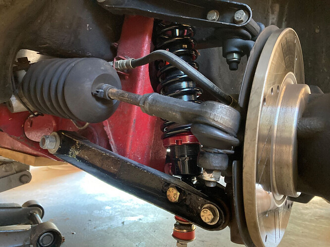

Finished up the installation and adjustment of my new dampers (AVO) and springs (12 in, 115 ft/lb), replacing some unadjustable, totally shot Armstrongs. Seems like a big improvement. Sourced from DBE.
Note - if you call them to order these, make sure to ask about the tool to adjust them. Apparently they assume that you already own one… If you don’t, it’ll be another $16 shipping, and about two weeks shipping in the Covid age, if you get one from them…
Will try them out on a trip to Eureka Springs, AR, tomorrow.
Steve,
That’s a very tidy front end.
One comment - something seems adrift with your inner bottom wishbone nut, which doesn’t seem to be on the stud far enough to fully engage with the nyloc.
Might be worth investigating further…
Yes - may be a case for half height nuts.
That’s what I have on mine after usin large washer to contain polybushes.

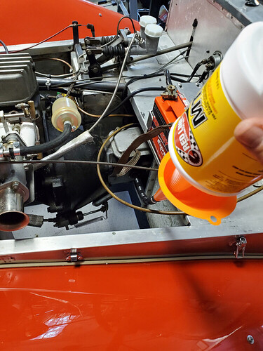

Changed my gearbox oil - sure is a lot easier on the Seven than the Elan!
A few tiny brass specks, but nothing significant in size or quantity aftter my long run yesterday. I did have a little scare when I got back and couldn’t get reverse gear to back into the garage. Knew I was lucky this morning when I opened the tunnel and the dome/cup tried to come up. It had worked loose so when I lifted the lever for reverse it was going way too far to locate correctly. Something a dot of blue loctite should solve.

I thought you only need a washer on the outside not both sides.
