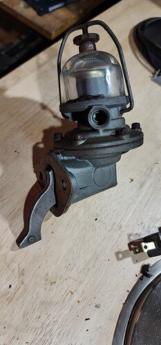

Hello everyone and thanks for your thoughts and suggestions.
As it happens, I still have the original off the car. When the garage put a new one on (this was some time ago now), I asked for the original back…
If I was to renovate / refurbish / rebuild the FP, how difficult of a job is it? Anyone actually done this here?

Good news that you still have the original fuel pump!..Always assuming of course that it is the original pump that Lotus fitted as original equipment and has not been previously replaced.
Yes I have fitted lots of these AC Delco pump overhaul kits over the years on a variety of cars. Not hard at all. Obviously it depends on your practical apptitude to such things but straightforward enough job.
You just replace the parts supplied in the kit.The diaphragm just hooks in place and the valves are usually staked to hold them in place in a couple of places so just need to be carefully re-punched over.
Not all pump overhaul kits contain the spindle seal rubber (top hat seal I call it) so try and get a kit that includes this seal.
15-30minute job.
Just a thought though…The all metal pump you currently have fitted is wrong and will deliver the wrong pressure and cause flooding but why was the pump changed in the first place ?
The original pump needs to go back in the car but that puts you back to where yoiu were in the first place so what was your original fault?
Bear in mind that Weber carb flooding can be caused by many things not connected at all with the fuel pump…
Alan.

Hello All,
I’ve decided that you’re all correct and that the best course of action is to referb. the fuel pump I have. I definitely prefer that route rather than adding new H/W in the form of a fuel p. regulator.
Any kit recommendations? I’m based in the US, so was wondering if there was a kit this side of the Atlantic to avoid the international shipping.
I did see that someone on a different thread referred to the ‘oil seal’. Is this a normal part of a rebuild kit?
@alanr, I also saw that you posted previously:
“Flexolite are the people you need for all AC mechanical fuel pump parts. They even sell the elusive rubber top hat seal (that doesn’t come in a repair kit).
flexolite.co.uk/categories/ … nd-filters”
Is this the same as the oil seal referred to above?

Both DBE and RD Enterprises have rebuild kits, no doubt.
Thanks Steve,
I looked at the kit from “RDEnt” and also the one from Flexolite. They were about the same cost but the Flexolite one seemed to have an extra gasket, so I ordered from there and just decided not to worry about the international shipping (which was a bit pricey)
Yes Flexolite do the full kit which I have used previously. Best to ensure that you have also ordered the ‘top hat’ spindle seal as well. I don’t think it comes in the kit.
Well Flexolite were pretty quick on the ball and have already shipped the kit. I guess when I open up the fuel pump, if the seal is damaged, I’ll have to obtain one then.
