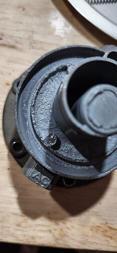

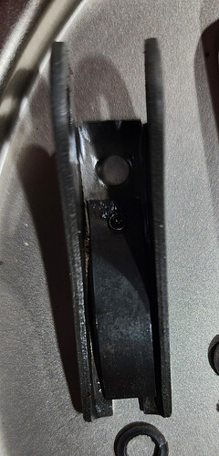

Well, I had some time today to open up the fuel pump.
A few things I’ve noticed. It looks like the FP has been rebuilt in the past and the internal components actually look ok.
Biggest concern is what looks like Pitting in the casting (Photo attached).
I’m wondering if this was not allowing a good seal between the glass bowl and the casting, thus the leaks.
Thoughts anyone?
It also looks like the valves have been previously replaced.
Does this Spindle Seal look like it is in good enough condition to stay or should I replace as a matter of course (I’d have to find and purchase one)?
If the spindle seal is still flexible, I’d leave it in.
I also noticed that the spring in the lever is very floppy and not acting as a spring at all. I’m thinking that the tiny rivet that attaches it is working loose.
That’s my inclination

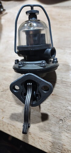

I have the Fuel pump back together.
The small spindle retaining clips were a royal pain to re-stake.

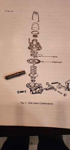

On checking the Workshop manual, it looks like the Fuel Pump should be attached to the Engine with Hex bolts. Mine has studs!
I guess I need to get two bolts. Any specs on the length+width? I can determine the thread, but what is the standard length for these?
The studs are 5/16" diameter which would seem a reasonable size, but they were just slightly too fat (by a hair ~ maybe a 32nd or 64th or thereabouts)
I’ve placed one of the studs on the assembly page here.
Thanks
Paul.
The studs are 5/16" diameter which would seem a reasonable size, but they were just slightly too fat (by a hair ~ maybe a 32nd or 64th or thereabouts)I’ve placed one of the studs on the assembly page here.
