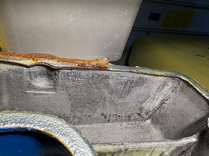

OK I think that was BS about some appendage in the van cover. In any case I don’t see any scoring in the metal from the chain hitting the cover, so we can rule that out.
The chain tensioner was still a little tight, but I adjusted that more exactly with the cover off. I do see a little mark where one of the sprocket bolts may be contacting the cam cover. I’ll include a picture.
Any ideas what might be causing the issue?

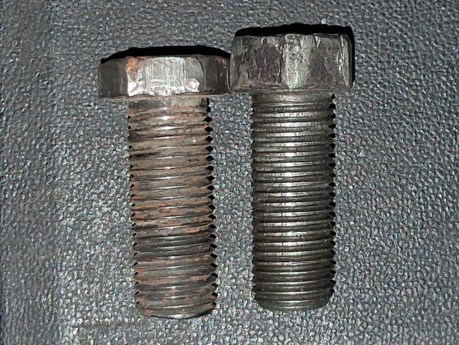

Cam sprocket bolts are usually half-depth. Possibly you’ve got slightly deeper ones fitted and they’re catching? They’re the same as a crankshaft pulley bolt except for the head being shallower.

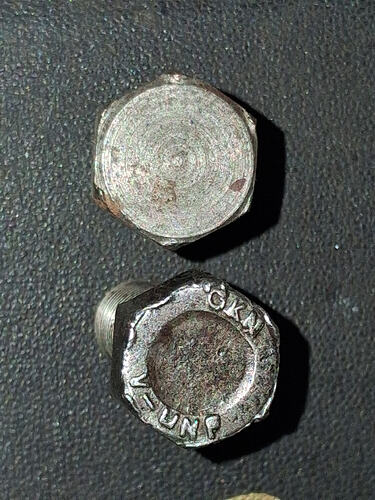

Crank pulley and cam sprocket bolt comparison. It looks like Lotus just machined the top off the head of a crank bolt as they are no identifying marks on the heads of those.
Looks like about 3/16s machined off.

Thanks for the suggestion and I’ll definitely keep it in mind as I move forward. I’ve got the cam cover off already, and at least some telltale scrape marks on the cover out by the sprocket bolts. I’m going to change out the bolts for ones with shorter heads and work my way from there.

Should there be a lock washer on the camshaft sprocket bolt? There is the large washer that fits into the sprocket, then the parts diagram shows a smaller washer between the bolt head and the large washer. It doesn’t specifically state a lock washer on either the RD Enterprises parts diagram or the DBE parts diagram.
I assumed it was a lock washer, which for the size bolt used is quite thick. An SAE washer would be less than half the thickness, which would probably account for the discrepancy. I checked and RD does not supply a smaller head on the sprocket bolt any more, so theoretically the bolts I have should fit. Of course, this is an Elan, and mine was definitely started on a Friday and finished on a Monday…
Thoughts?
Tony
Yes a spring-washer / lock-washer is present there. I’ve seen them have thin profile ones but usually they are - what looks to my eye at least - standard thickness.
