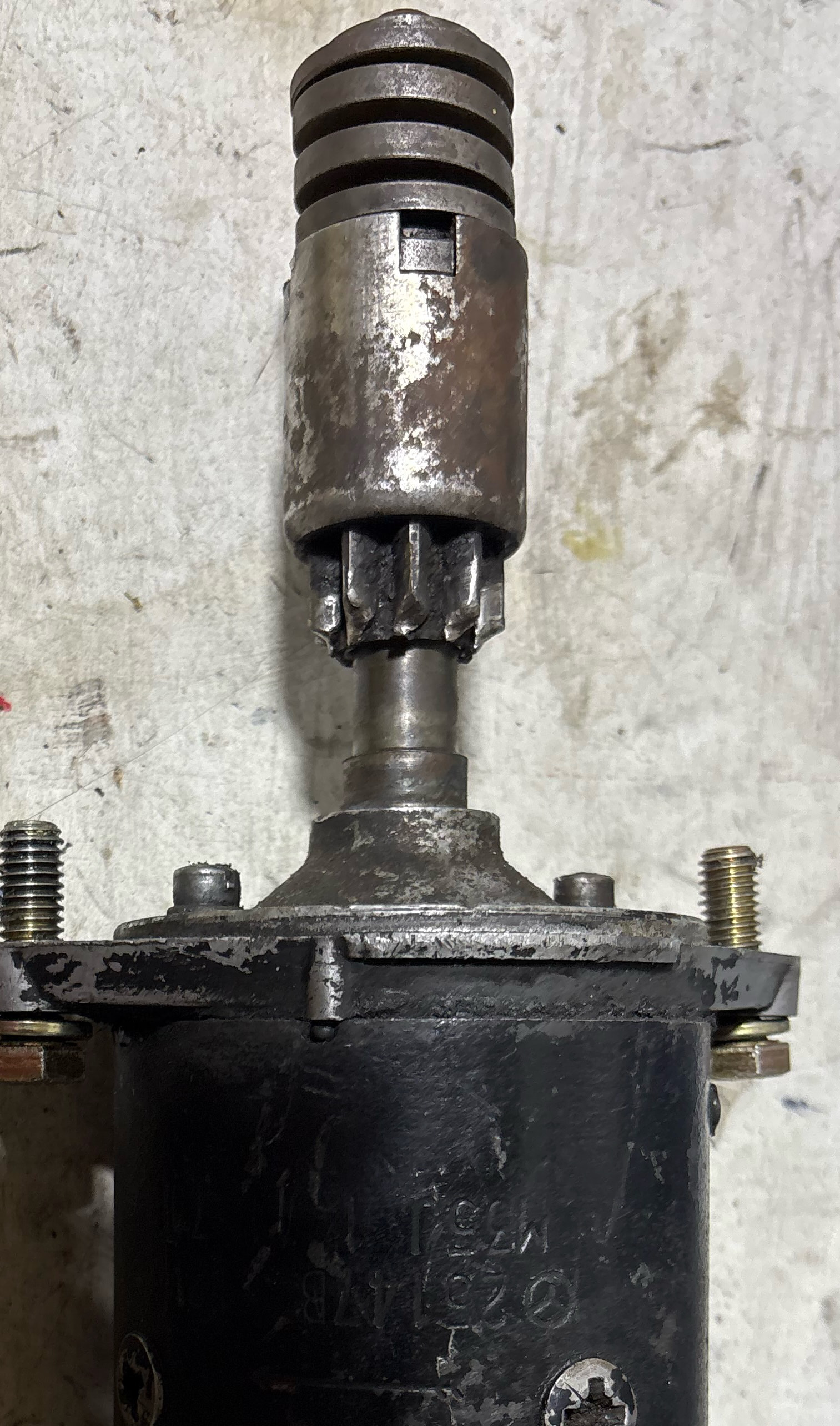

After more research I read that as the inertia starter gets older, it doesn’t retract fully after the engine starts, and the end of the pinion gear can contact the ring gear and make a noise. I was getting ready to start the car and drive it up the ramps so I could pull the starter out. When I tried to start it, I heard a load crack and the starter just spun without engaging.
I thought the starter had gone so I pulled it out to have a look. Sure enough, my pinion gear was pretty chewed up, which may or may not have been the problem. Since the loud crack was the ring gear extricating itself from the clutches of the flywheel, I don’t know if the starter was the source of the clicking noise. But from the state of it, it seems plausible that was the issue from the start.
Hopefully when the engine goes back together, with a new ring gear and a new gear reduction starter, this problem will have gone away
