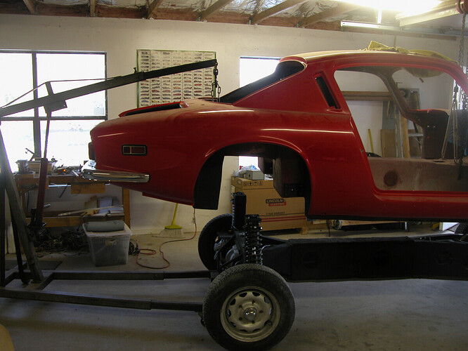

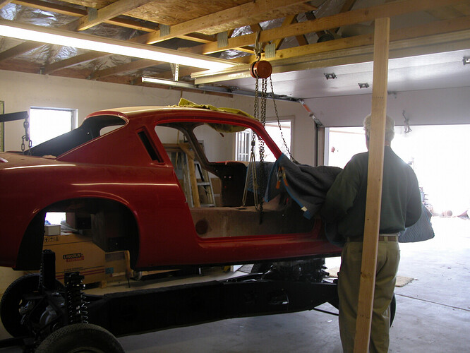

here are a couple of pictures of my body going back on. Used an engine lift at the rear to body mount holes in boot floor and a chain hoist through the windscreen to body mount holes behind dash on the tunnel. The helper in the photo is about 6’ 2’‘. Normal height shop roof, 8’. Note chassis is complete. Not as hard a job as I expected. Body not that heavy or unwieldy, although it was a little tippy and we had to keep a hand on it so it did not start to roll, but not bad. Gary

I had removed and cleaned the side sills. Being a desert car the sills and chassis were not rusted, just dusty and in need of new paint. The support visible in front of my friend was to support the roof truss near chain hoist but I don’t think it was really needed. Just cautious. Body was bare, nothing but sills. Gary
Gary, great idea and pix. Would not have thought the bobbins could support the pull upward! Thanks. Dave
