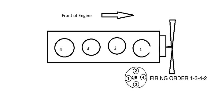

Before I do as Tim suggested (with the taking of photos) I wanted to check with you all that I have got the firing order right. I know, of course, that it’s “1,3,4,2”, but as the rotor arm turns anti-clockwise should it therefore be “2,4,3,1”?

Thank you pharriso - that’s very clear!
Just replaced the image with a clearer one. :slight_smile:
