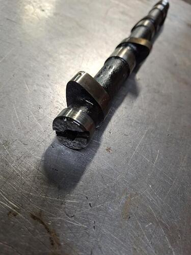

A BROKEN CAMSHAFT!!!
So I bought TWO (in case the other one was ready to brake, but also so that the two camshafts would be matching) new camshafts and the camshaft bearings (from S J Sportscars) and the garage fitted them. And it now runs.
That’s why I put “So my 123 ignition (and indeed my original Lumenition ignition most likely) works just fine.”
What caused the camshaft to break is a total mystery. See attached photo of the camshaft.

The break location at the oil hole in the front bearing is where they break when you have excessive chain load. Normally its the exhaust cam that breaks as it sees more load than the inlet. I am amazed you did not bend any valves. Have you checked compression?
As to why it broke no clear answer that i can see. Maybe with the probe put into the cylinder to check piston position during all the timing attempts it clashed with the valves jamming them and this then overloaded the cam, I have seen that done before, Maybe just an old casting defect that took a long time to fail. Were the cams and springs standard lotus ?

It sounds like it was all my fault as initially I tightened the timing chain without taking the cam cover off, trying to get rid of a rattling noise. Still without taking the cam cover off I tightened it and tightened it until I could not tighten it any more. Each time between tightenings I took the car for a drive to see whether I had got rid of the rattling noise. Eventually I did the job properly, removing the cam cover, discovering that the timing chain was much too tight and therefore slackening off the chain accordingly.
When I took the cam cover off I was only concerned with getting the timing chain tension right. Perhaps had I looked I would have spotted a crack in the inlet cam!
I’m glad I had both camshafts replaced, as perhaps the exhaust cam was ready to brake too.
As far as I know the cams and springs standard Lotus, but of course I have no way of knowing, my Elan having passed through many hands before I bought it.
