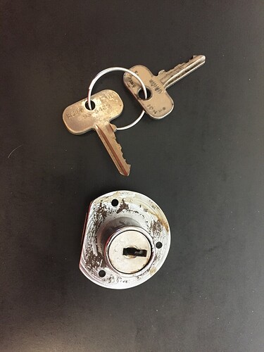

It took me a week to find an actual lock smith shop that does auto lock work. Seems everyone has a mobile business and operates out of a van. All these companies weren’t interested in fitting the lock cylinder to a key of a 50 year old English car.
Went to this small shop in Trenton NJ that has been in the same place for 30 years. Nice guy who said he can fix or repair anything mechanical. Not good with computers or electronics.
I showed him my glove box lock and the two keys I had that came with it that won’t open the lock. Took them into his shop and 2 minutes later said, these aren’t the right keys, got anymore? Nope. That is what I have. He said he could cut a new one from his stock (was for a Fiat) and would be able to cut one of the old ones to fit. 10 minutes later and $25 poorer I had a glove box lock and keys that work.

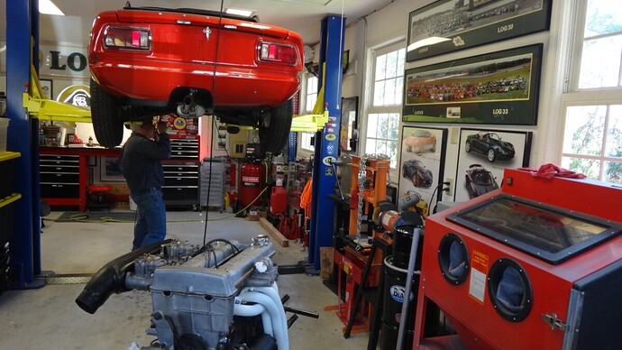

I’ve been away from working on the Elan S4 for a couple of weeks (other commitments and travel) so I was eager to get going again on finishing the rebuild. Nothing like a full day in the garage !
Drew and I had planned working on the car today a couple of weeks ago so we had our schedule set. I woke up this morning to 50mph+ winds howling outside and the power flickering off and on. Well I thought, this will make it interesting. I expected many trees down as it had been raining so I had low expectations the day would turn out as I was hoping. Luckily I only had small tree limbs come down, nothing major.
Drew and I went thru the “items to be done list” I had written a couple of weeks ago so we wouldn’t forget. Top of the list was re-installing the rebuilt generator and lowering the radiator mounts.

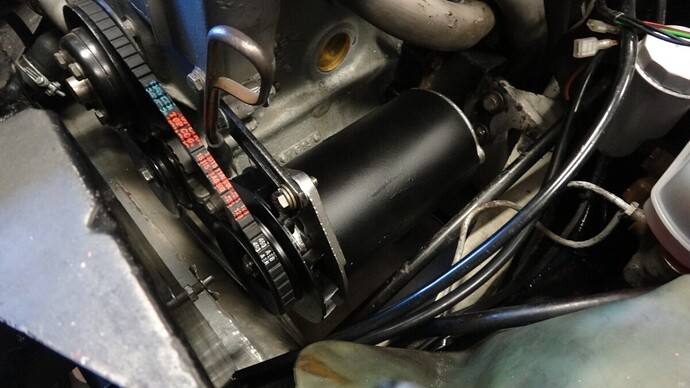

The generator needed rebuilding as it wasn’t charging the battery. We had a company that specializes in this rebuild it. The install was easy.

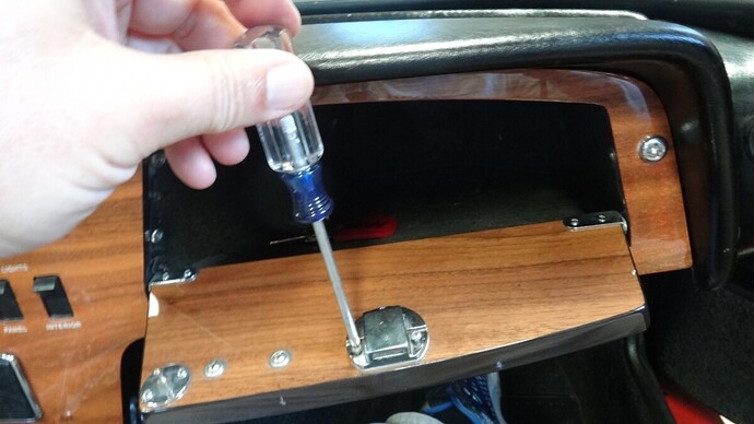

I had the glove box lock rekeyed so I reinstalled the lock. All worked fine. The bracket that holds the clasp catch for the door will come next, but I media blasted it and started to paint it black so I’ll install next week.

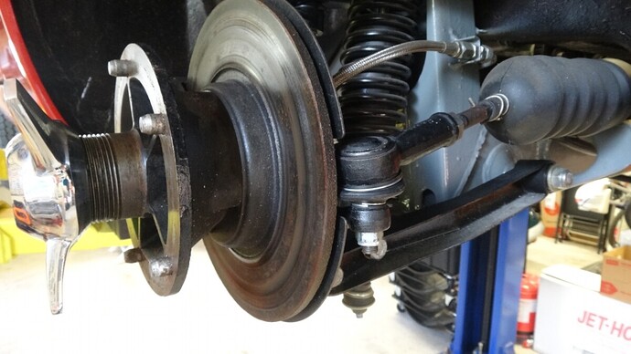

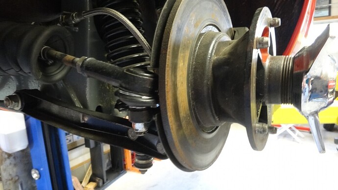

Needed to install the tie rod boots as they had been eaten away by mice when the car was in storage. Removed the tie rods, made sure they were packed with grease and installed the boots.

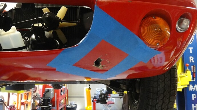

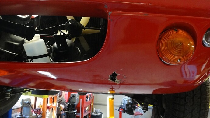

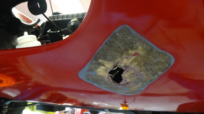

We moved to the front of the car and decided to tackle the fiberglass repair that we had been ignoring during the entire rebuild. When I bought the car there was a small hole in the lower left bottom cowl of the car. I knew this was not a bondo job so I purchased a fiberglass repair kit. As in all fiberglass repairs, the prep of the area is the key to success (I have owned a number of fiberglass sailboats boats in my life, I know what I’m in store for with this repair). We masked and wet sanded the area down, outside and inside the area. Will leave it to dry until next week and then start the fiberglass repair for this area.
