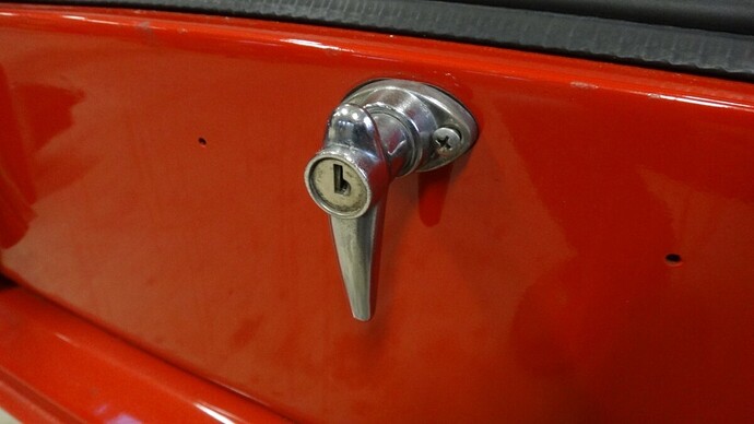

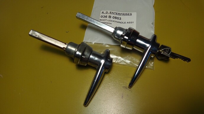

I had ordered new locks for the doors and the boot as the keys didn’t work and that would drive me nuts. Ray at R&D had what I needed in stock and shipped them straight away. I wasn’t worried about replacing the boot locking handle, that seemed simple enough…and it was. Although I looked at a number of photos of cars to determine if the locked positon is up or down. I couldn’t tell which was right so I picked locked up as it doesn’t interfere with the license plate.

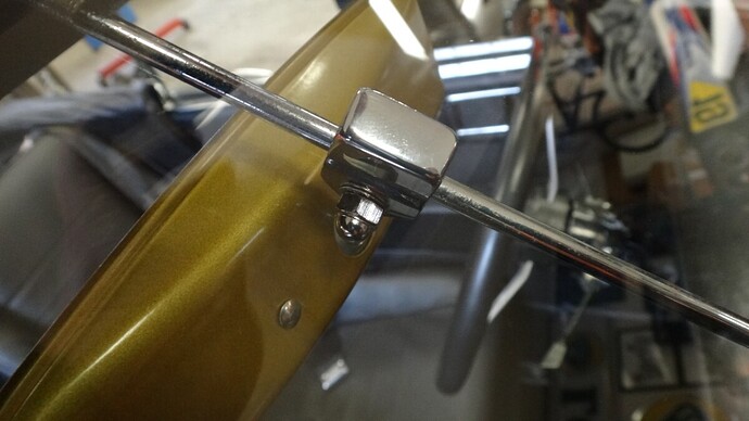

I had also ordered a new rear view mirror from R&D as it was the proper type and the back was gold which will match the bumpers!

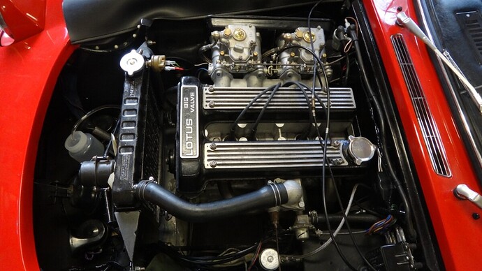

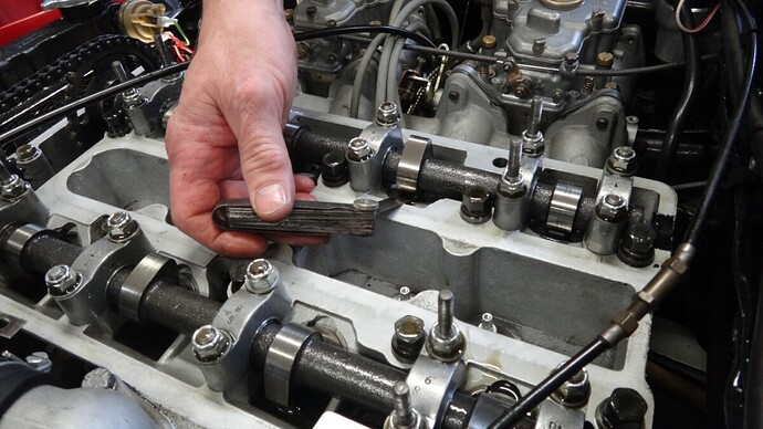

Drew pulled the head/valve cover while I was working on the locks to check the cam shaft to valve clearances. Everything was to spec.
He then replaced all the distributor to spark plug wires and coil wire with a new set (the old set was more than 15 years old).

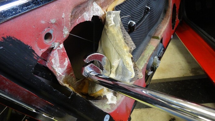

I was deep into the replacement of door locks. Not much in the way of instructions in the Lotus shop manual or Bucklands book. A couple of posts on this website said it was a total pain to do…but I persevered. The removal of the locks themselves is interesting as there is alomost no space to put a wrench inside the door with the window installed. I came up with the brilliant idea of using a plumbers wrench to remove the locking nut on the back of the door lock and it worked perfectly!

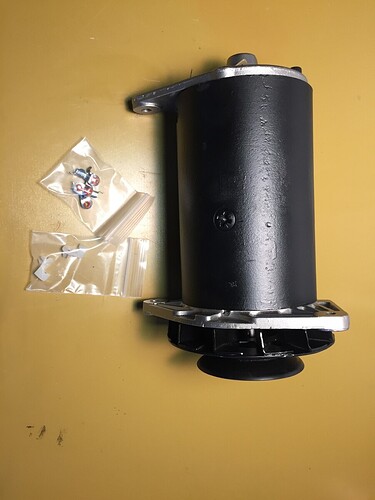

The rebuilt generator hasn’t come back from the shop, but that should be next week. Unfortunately my schedule is packed the next couple of weeks and so is Drew’s so we are probably not working on the S4 again until April (at least that’s what we put in our calendars). But that is OK, we are close to completion and it will be warm out in April for more test drives :slight_smile:
Rebuilt generator and door clips. Now I just need some spare time!
Well you proved Murphy’s law… 50:50 & you were wrong… The long part of the lock handle should be down with the lock latched… :unamused:
Figures. Where were you when I was installing the boot handle Phil? Another fix back on the list!

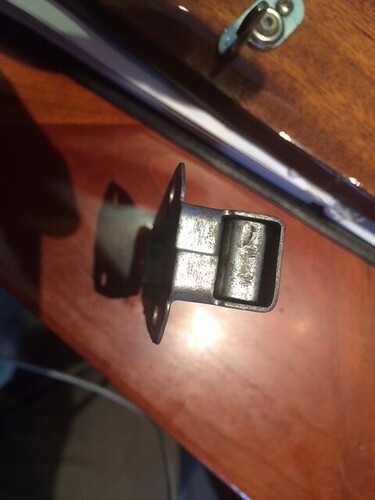

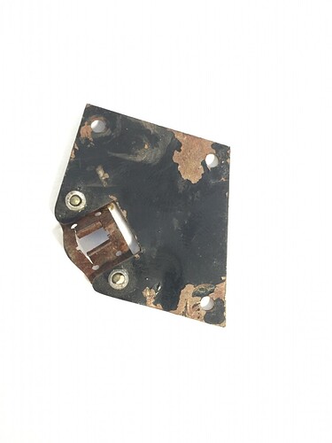

It’s the details that count! Sourced the bracket that holds the pin to keep the glove box door closed. Will media blast and repaint.
Where on earth did you find that??
I’ve found a source that seems to have almost everything I’m looking for. Amazing. Expensive but amazing.

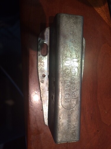

The glove box latch on my S4 is much different (45/9182).
It says “Limread Tutch Latch”. It’s a spring loaded affair.
This is the original equipment, as I am the original owner.
Forgive me, but the latch you have looks a bit “home-made”. But perhaps it is correct as your car is a bit earlier than mine.
If it works, great.
Glen & my cars are identical, maybe just federal late S4 & Sprint?
1owner69elan, interesting glove box catch you have on your car. I now have a sample of two types to reference. Can anyone else provide a photo of their glove box latch system? I’d like to know what is “typical” ?
I happened to be looking at my 1969 parts manual (obtained directly at the factory at the time I picked up my car)…
The “Tutch Latch”, part no. 036 B 6150, is referenced for the S4 from car no 7895. So, in theory, as we know not everything is consistent with the Elan, the touch latch would be appropriate for your car no. 7941.
A quick google and it looks like these latches are still available new:
hafele.co.uk/shop/p/automati … 12048/9610
This looks identical to the OEM one I have. Includes the catch that attaches to the door.
This a push touch type latch, no handle on the door. Push close, push open.
