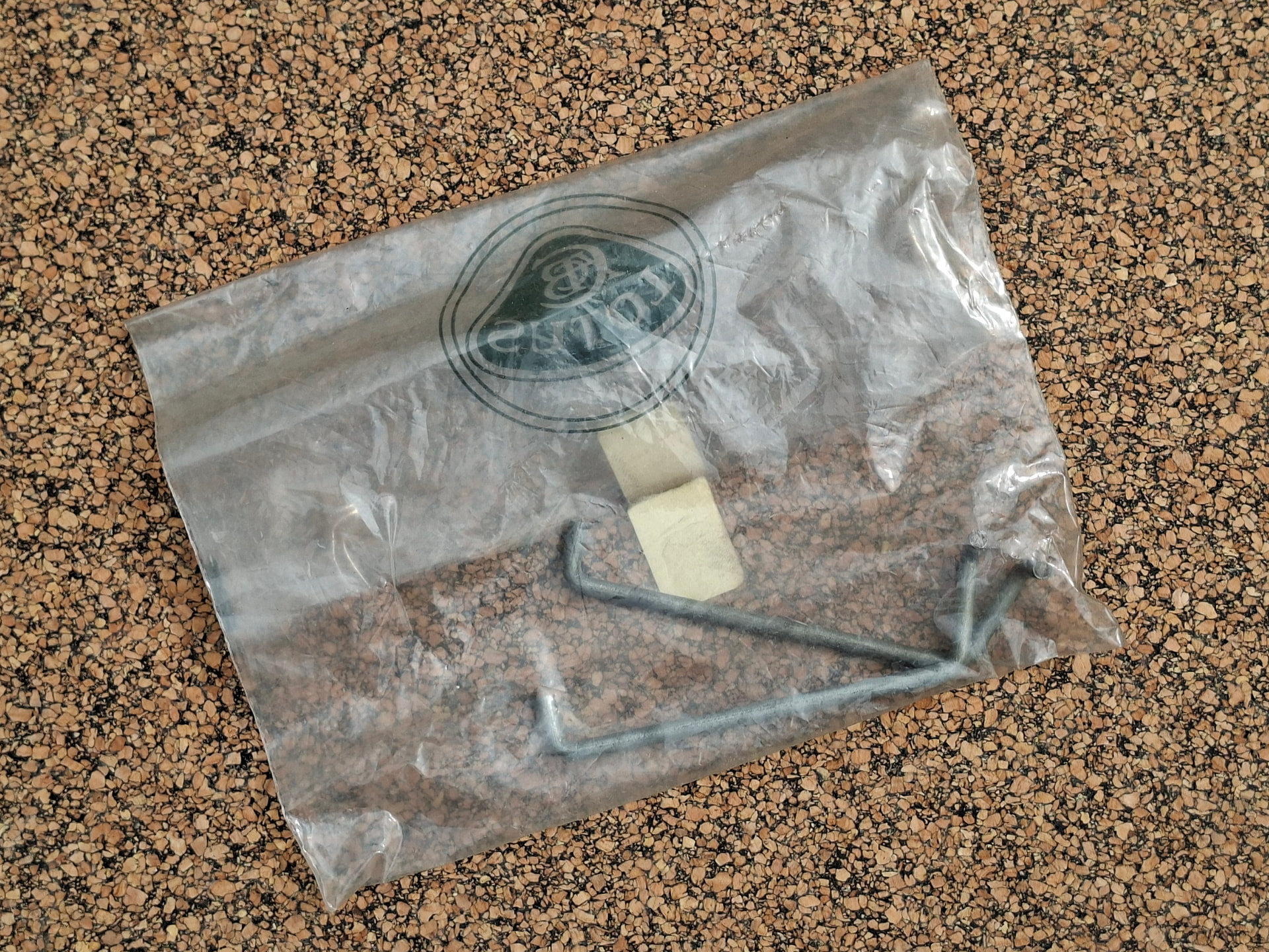

Hello,
I’m looking for some help in identifying the part number of these rods.
Any answers would very much be appreciated.

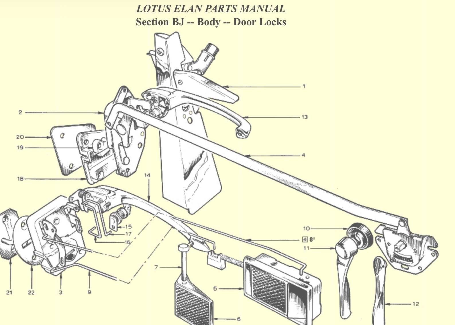

These look like door lock rods from an Elan. Never got round to fitting mine back after removing them as a fiddly job!
Parts diagram from RDent
Richard
On the Plus 2, it is the same purpose. It appears to be part labeled number 45.

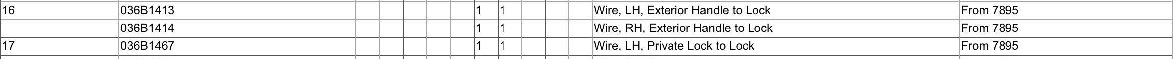

| Item | Lotus # | All | +2 | +2 FED | +2S | +2S FED | +2S 130 | RHD | LHD | Description | Change Point Notes Bulletin Reference |
| 036B1647 | 1 | Wire - Private Lock to Lock LH | From Chassis No. 0929 | ||||||||
| 45 | 036B1648 | 1 | Wire - Private Lock to Lock RH | From Chassis No. 0929 |
