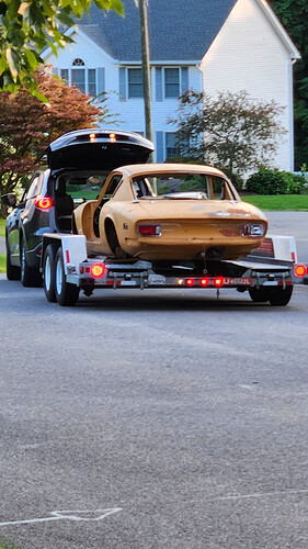

It’s a 1971 Lotus Elan +2 S. Build date 12/70. Body 00091-N.
Before anyone gets too excited, the seller only had the body shell for sale. It appears to be completely original, down to the early 70s strange Pumpkin Orange paint. It doesn’t even have a Chassis under it!!
No front or rear glass either. Both doors do have glass tho.
No interior, except for a British dash which is very weathered. I hope to save most of the Smiths gauges?

In the meantime, I found this beautiful all original +2 body. Unfortunately it’s nothing but the bare body shell!
I’ve already heard back from Spyder in England. They will NOT modify their chassis in order for me to fit the 3.5 V8. So I’m on my own if I want to attempt to notch the frame rails!
At this point, I’m still just doing the research to determine if this is a viable project?
