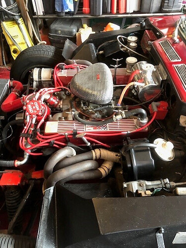

You would have to cut the front end off and upgrade everything on the drive train as I did. And I agree the Zetec engine is by far the easiest option but you will never have the sound of a V8 :smiley:
