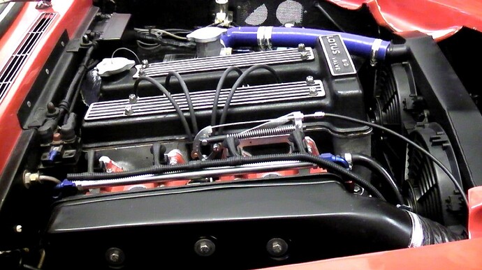

You can see in the picture how the solenoid has been moved when the Webers were replaced with Dellortos.
I don’t know if it makes a difference but my solenoid body is rotated 90 degrees compared with your photo?
Carl

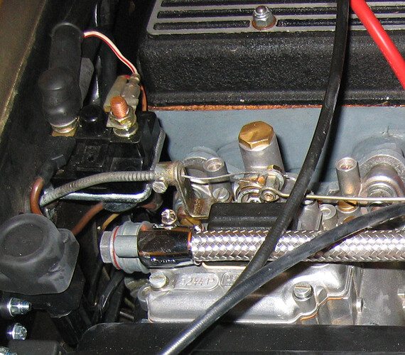

Carl is correct - your solenoid needs to be fitted 90? clockwise in the picture with the positive cable running along the bulkhead.
Perhaps this picture helps:
Brian/Carl
The solenoid does seem to match the position shown in your car (Brian) but yours is fitted much closer to the engine than in mine and will be I hope the answer.

The solenoid hasn?t been rotated but the battery and starter cables are on the same terminal because it?s a pre-engaged starter.
Here is a clearer picture.
Alan.
Richard,
I seem to have forgotten the rest of my message :blush: - I meant to add that the centre of the solenoid is 175mm from the body centre in my car. Perhaps this dimension will help.
Brian
I have now relocated the solenoid and your centre to centre measurement is spot on - must now endeavour to reshape the battery cable to make a nice fit through the bulkhead also to find a tidy way to secure the ‘solenoid to starter motor’ cable
