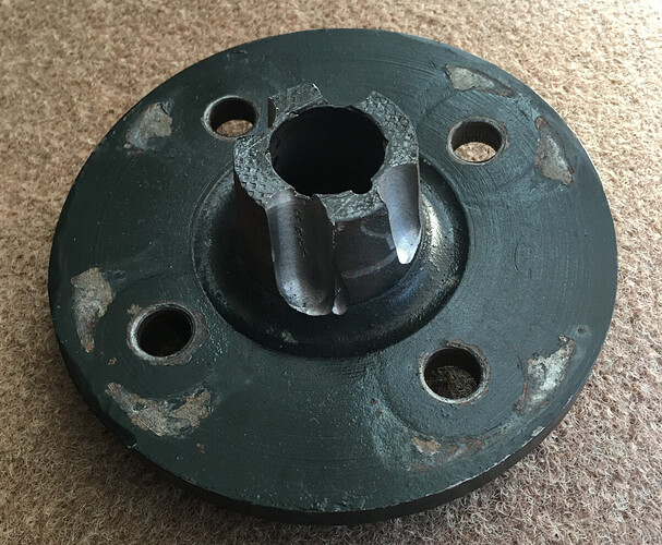

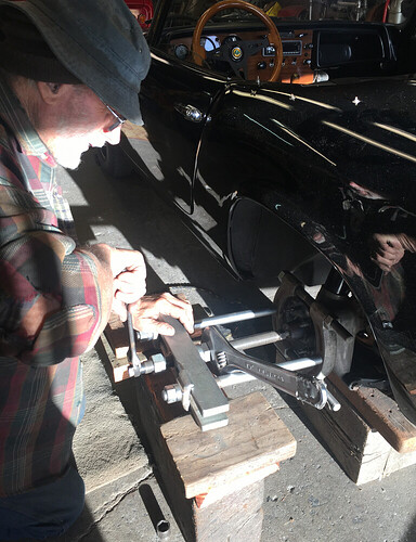

Driving home one day I was followed, for a few miles, by someone who wanted to notify me of my rear wheel wobbling. They successfully did so when I was about to drive into the driveway. Curious as to the potential cause, I removed the wheel and visually inspected the hub, upright, etc. and found no obvious telling signs. Reaching out to Mike and presenting the issue, the suggestion was: you may have a bent wheel, worn wheel bearings, or bent hub. Easiest to test was to fit the other wheels which did not experience any apparent wobbling onto the rear hub. Sure enough, all tested experienced the same wobbling. The car has only been driven a few thousand miles since a complete rebuild so the wheel bearings were not top of list. Next was the hub, and testing the others as well for run out. The wobbly wheel corner showed a range of -10 to +55 thousandths variance while the other three displayed -2 to +3 or +4 thousandths of an inch. Clearly, I found the issue. Now to removing the hub. With bolt on wheels, we used Mike’s massive hub puller clamp to attempt to remove the hub. Nothing budged. We applied heat; still nothing. We left the torque laden clamp fitted overnight hoping for the hub to be freed by the morning; again nothing. Applied further torque, still nothing. Knowing this hub was destined for the bin, we then began drilling away iron near the center to weaken its hold onto the shaft, carefully drilling so not to drill through and contact the shaft. Voila, after many hours of attempts, the hub was finally freed. Fortunately, Mike had a good used spare hub in his parts collection which was fitted and tested for run out. It measured similarly to the other ‘good’ hub on the opposite side of the car. We then test the fitted wheel, car raised off the ground, by placing the car in 1st gear and driving (or flying) the car in mid-air. No new signs of wobble… so time for a test drive. Success. My rear wheel wobble is gone. Thought I’d share this with those who may face a wheel wobble dilemma and may consider similar diagnostic steps.

Generally the bolt on rear hubs are bent by using a 3 jaw puller to remove them.
Hi, Rohan. I have both 3 and 4 jaw pullers. I use this full sized monster as it encapsulates the entire back of the curved hub. Usually with some oxy/acel heat they will pop off. This recalcitrant hub was very difficult. When it did let loose, the noise was like a cannot shot. No evidence of any corrosion along the taper. Careful carbide grinding, per the picture was the key on this job. No tapered axle (s) were harmed! Always enjoy your contributions to the forum. Wish I could pop back down, but last visit was in 2003 to examine Elite #1001 (the first) down in Gee Long and then work up to Cains for some snorkeling, visiting Elite and Lotus folks along the way. Cheers. Mike, in the San Francisco Bay Area, for your visit.

I use a large bearing splitter behind the hub and hydraulic puller. The bearing splitter fits in behind the hub up clode to the axle shaft so minimal bending load on the hub flange.

Yes, my puller is a split bearing type. Fits nicely behind the convex hub.
