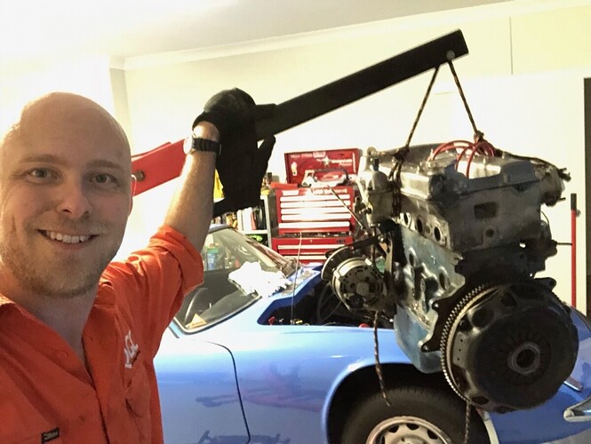

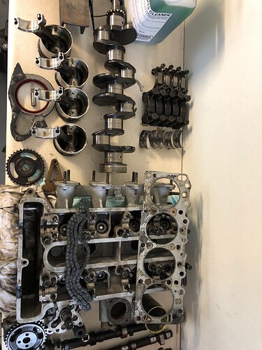

Just a little bit of minor work :laughing:
