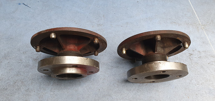

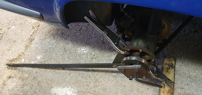

a too long awaited maintenance : rear KO hubs removal for installing new pegs.
as my proper Churchill tool is still in the UK to be shipped with other parts, I used an ad’hoc tool : 8 tpi threaded disk with high tensile 10mm bolts to press a socket on the axle via a steel plate.
a couple blows on the center while in tension was enough for the RHS, the LHS required an additionnal light heat with a propane torch.
The rear wheels had shown a tendency to get loose on wet track days, due to the Quaife rear end hammering action I suppose : I’ll give them an good inspection (play with the matching wheel, to which I’ll add inserts if necessary)

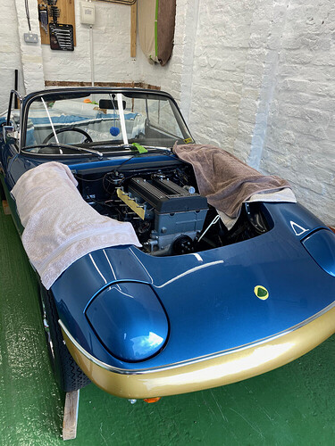

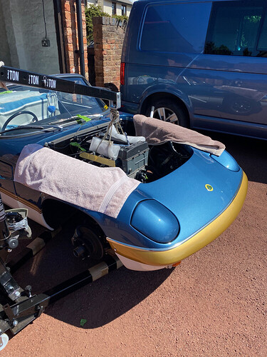

5 speed box installed followed by the engine…
Almost there I hope…
Nice, looks like a beautiful garage as well.

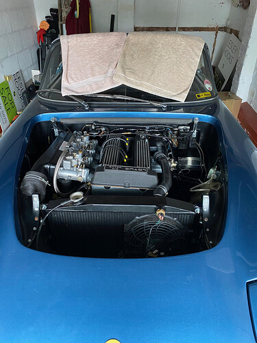

All back in…
1 « J'aime »
and the bonnet fits ? :wink:
Very neat

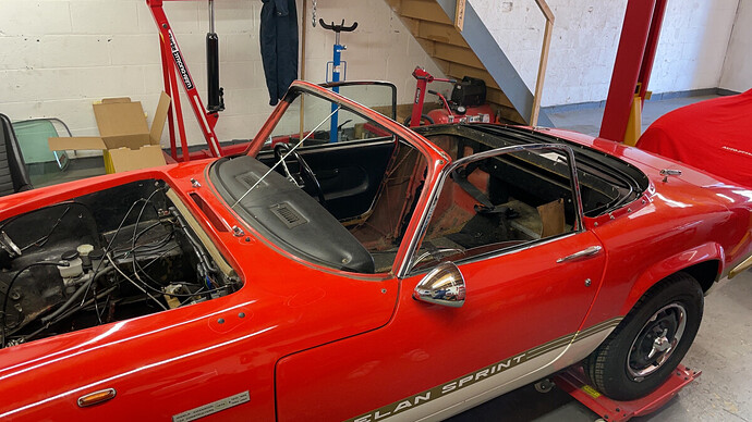

A couple of days ago my son and I started disassembling our Sprint. The car is a '72 RHD car which hasn’t been a part before. The chassis is in remarkable condition, but then the car spent the first thirty years of it’s life in the Channel Islands so it was spared salted winter roads. Nothing interesting or unusual to report in the tear down, but I did find some old Dutch 1970’s coins under the seats.
