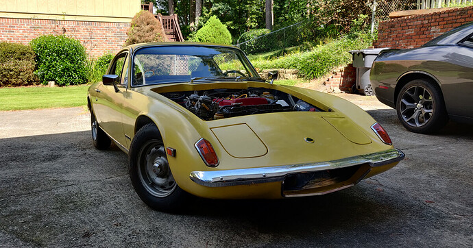

More results following yesterday’s big news. Today I got a safety-belt installed, cleaned the glass, and went for a shakedown-run near home. First thing was a stop at a nearby petrol station since the tank only had about three gallons in it and I was curious to see if anything would leak with more. Nothing did!
The car did well overall, and I was pleased that it handled well and the front alignment seemed to be mostly correct. I did notice during a brief blat up to about 60 MPH on a large divided road that some jiggles on the steering wheel didn’t translate into much response from the car, so some further refinement may be needed. Or maybe the missing bonnet was causing a little aerodynamic lift? I doubt it but we’ll see. It’s not getting put back on until I’m done with a few other jobs anyway.
The sticking clutch master cylinder was annoying at times but did seem to improve some with use; time will tell if it clears up altogether or I get sufficiently impatient with it to buy a new one.
Two disappointments: after about ten miles I noticed that the blend of funky smells was changing a bit and at a stop I saw a little smoke. More of it at the next stop, coming from the front-right corner, and the brakes got a little soft. Uh-oh. I made for home immediately at that point (thankfully I was less than a mile away), and noticed that it didn’t really want to get above around 2500 RPM at as I got onto my street. I recall too that mid-range acceleration seemed tepid earlier in the run.
Upon parking at home I found that the front-right caliper was leaking a little, which doesn’t really surprise me considering that I have no idea when or if the calipers have ever been serviced. Will order some caliper-rebuild kits and new pads and install them before driving again.
Looks really good, Ben. Unlike the rears, rebuilt front calipers are generally available - so as you get them off if the’re looking rougher than you expect you can send them off for exchange for a rebuilt pair for not too much more than the cost of parts to rebuild yourself.

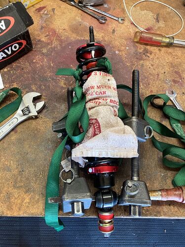

My next project is to convert from whatever shock/spring is on the car now (only a couple of POs before me might know) with shocks adjustable for damping and ride height with 12" 115 lb/in springs.
I checked out RDE and DBE and went with what DBE has been providing for years - AVO shocks withe the 115 springs.
The firsts challenge is that DBE doesn’t mount the springs for you. Ken @ DBE sent me a picture of how he does it - using a std external spring compressor hooked at the bottom on a bar through the lower shock mount, and hooked to “S” hooks at the upper end of the springs.
I borrowed a spring compressor from Autozone and followed Ken’s process, except used nylon strapping instead of S hooks to attach the compressor.
So now the springs are on the shocks.
The next challenge - the shocks didn’t come with a wrench to adjust the height, I guess I need to call Ken back and see about that…
And then get them on the car - any tricks to doing that?

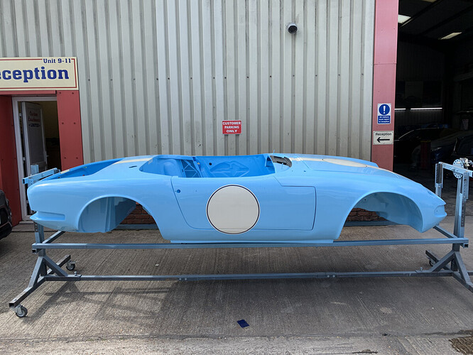

Picked the shell up from the paintshop :smiley: :smiley: :smiley:
That is one beautiful shell.
Very nice :smiley:
