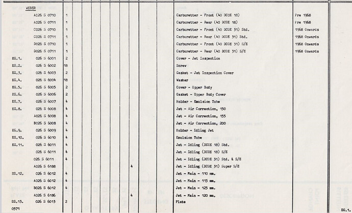

I used to have a 1967 S3 SE (36 /75XX) it was fitted with DCOE 18’s, from the parts manual it looks like 31’s were fitted from 1968 but don’t believe new 18’s or 31’s are available anymore (unless you find some NOS but unlikely.
The modern equivalent would be DCOE 151’s, do a search on the forum for 151 carbs as they will need jetting and I think there is should be some info what others have used.
THanks a lot Brian,
By the look of this document the 68 S/E were fitted with DCOE 31’s?
I found new DCOEs 18 so i was going for this, but if 31 were fitted then maybe 31.

A '68 Elan S3 would have had 31’s.

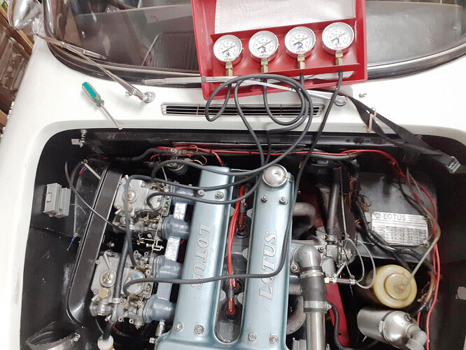

Hi all,
Just a quick update here.
I received and installed the Weber 151, applied the settings given by Lotus as OEM settings for a 68 S3 S/E
The result is not that great, with some flat spots at low rpms, uncomfortable progression and lack of power.
I cannot really count on jets that were installed on previous carbs as those carbs were not the original ones at all (it makes part of the discoveries you make when you buy this sort of car from an unreliable seller :unamused: )
I have no choice but to start from scratch in order to get a decent result.
By looking at the information on the forum (and especially the ones given by @ElanS3), the factory settings for the S3 S/E were not really accurate and a fix was then added to the factory workshop, giving the following settings :

I have 151 Webber’s and I find that 50F9 idle jets made a substantial improvement
Ed
