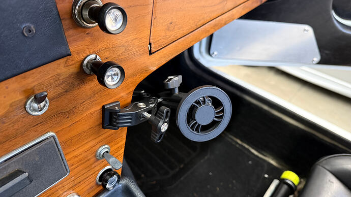

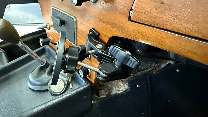

I saw some discussion in the Plus 2 topic regarding phone mounts. I toyed with doing something using the radio blanking plate in my car but did not like the phone jutting out from that particular location. I found a clamp on Amazon that looked like it would respect the dash panel, and so far it has. Link below.
Here are a couple of pics.
