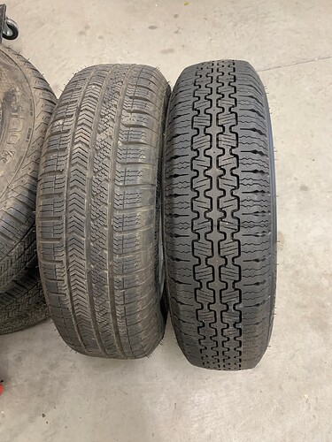

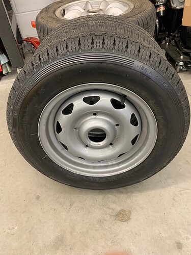

A few months ago I took advantage of a sale price offered by Lucas Classic Tires to pick up a set of Pirelli Cinturato CA67s in size 155HR13. I finally got around to getting them mounted on the steelies. I am very pleased with the way they look, and I am impressed with how the car drives with them as well. My “ten minute” Elan experience notwithstanding, I get a true period feel from them as compared to the more modern Vredestein 165/70R13s all season tires that were on the car at purchase. I’ve been informed that the modernized Michelin XAS is also a very good tire, but I can’t pass up a bargain!
The kombi arriving back home with a buttload of tires. It actually had 4 more in it on the way to the shop, but one VERY old set of tires stayed behind.
A couple of comparison images of the Vredesteins (now transferred to the alloy rims) versus the Pirellis.

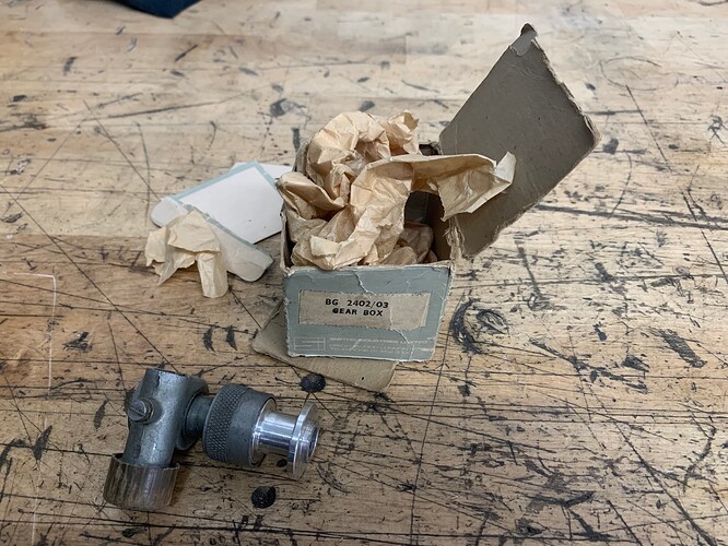

Among other stories, I regaled him with my speedometer angle drive adventures. “Angle drive”, he said, thinking. “What do they look like?” I showed him a picture. He walked over to a drawer and pulled this out!! I told him I am going to start making weekly trips to his house, if only to collect all the parts he keeps finding.

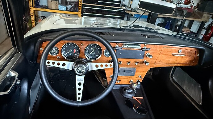

I secured a ‘Colin Chapman’ S4 steering wheel and finally had a chance to test it out yesterday. This will sound hyperbolic but it fundamentally changed my relationship with the car’s steering, in a good way. A very good way. The steering feels a little bit faster, a lot more direct, and more responsive. The new-to-me wheel is about an inch smaller in diameter, the rim is thicker, and the overall structure is much more rigid, compared to the original. My original desire was for a slightly fatter, smaller wheel, which this is; I just had no idea how much difference it would make to my enjoyment of this wonderful little car. I love it.

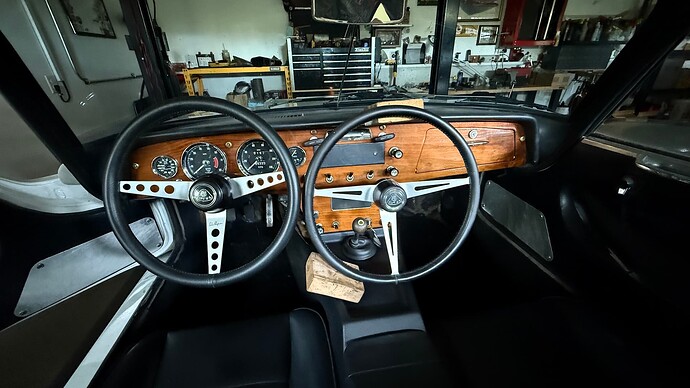

Here’s my best shot at pictorially capturing ‘old’ vs. ‘new’.

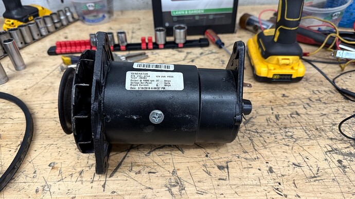

The reason I said “finally had a chance” is that the car stopped making volts last week. I’m fairly adept electrically and I have a spare generator, so I set about trying to rectify the situation. All for naught. The spare was in worse shape than the one on the car, and neither were producing volts during bench testing. So I went searching and found one in a place I was quite surprised by – NAPA Auto Parts. They actually had a remanufactured Lucas generator! And it works!! It even had a little rubber plug in the oil hole, something I’ve never seen before in 50+ years of wrenching on English cars. All I did was swap the pulley over to it. (I will leave my opinion of the local NAPA store out of this, suffice it to say I won’t be back there.) Yes, I could have gone with an alternator. That would have meant rewiring as well as converting the car to negative ground. That will happen, just not today. Today I want to Drive. The. Car.

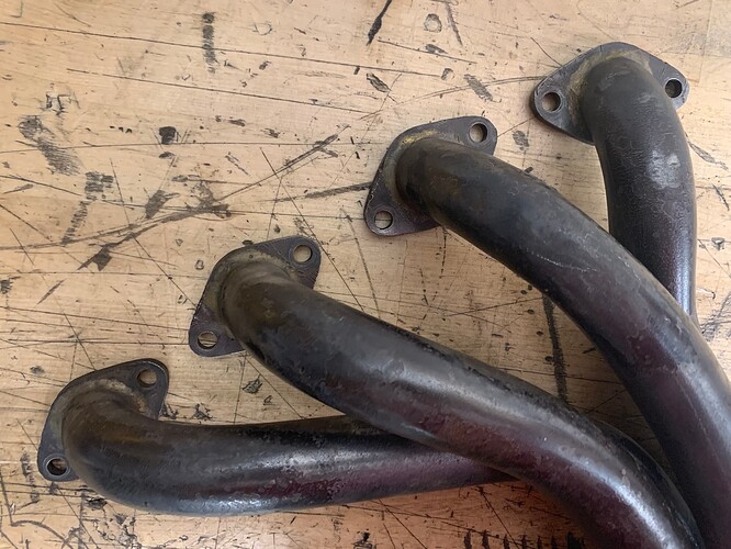

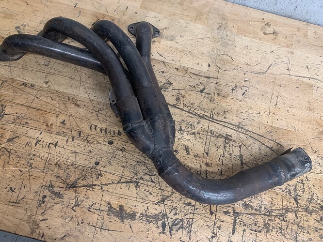

Next up is the oil drain “breather” tube that’s squished between the head and the block. I intend to install my other engine over the winter but the leak is too big to ignore until then.

As much fun as I’ve been having driving the car, I must also admit to some frustration over how much oil leaks out of the engine. As mentioned previously, much of the rubber on the car has deteriorated over the decades, and there was a great deal of oil coming down the carburetor side of the engine, so I suspected the ‘breather’ drain tube between the head and block. I did some reading here on replacement and was happy to see that some have replaced the tube in situ without removing the cylinder head. This suited my purposes perfectly, so I visited RDEnt and picked one up – along with several other bits, as per usual!
I was surprised to find that the one I removed was in pretty good shape. I know the head has been off the car and I assume the tube was replaced at that time. However it did not appear that any attempt was made to add sealant around the mating surfaces. I was able to get the new one installed, thanks to tips and tricks learned on this forum, and it is sealing well. I took an extended drive yesterday and was happy to see, well, nothing, on that side of the engine when I got back. Okay, okay, maybe the fuel pump blanking plate is seeping a wee bit…
