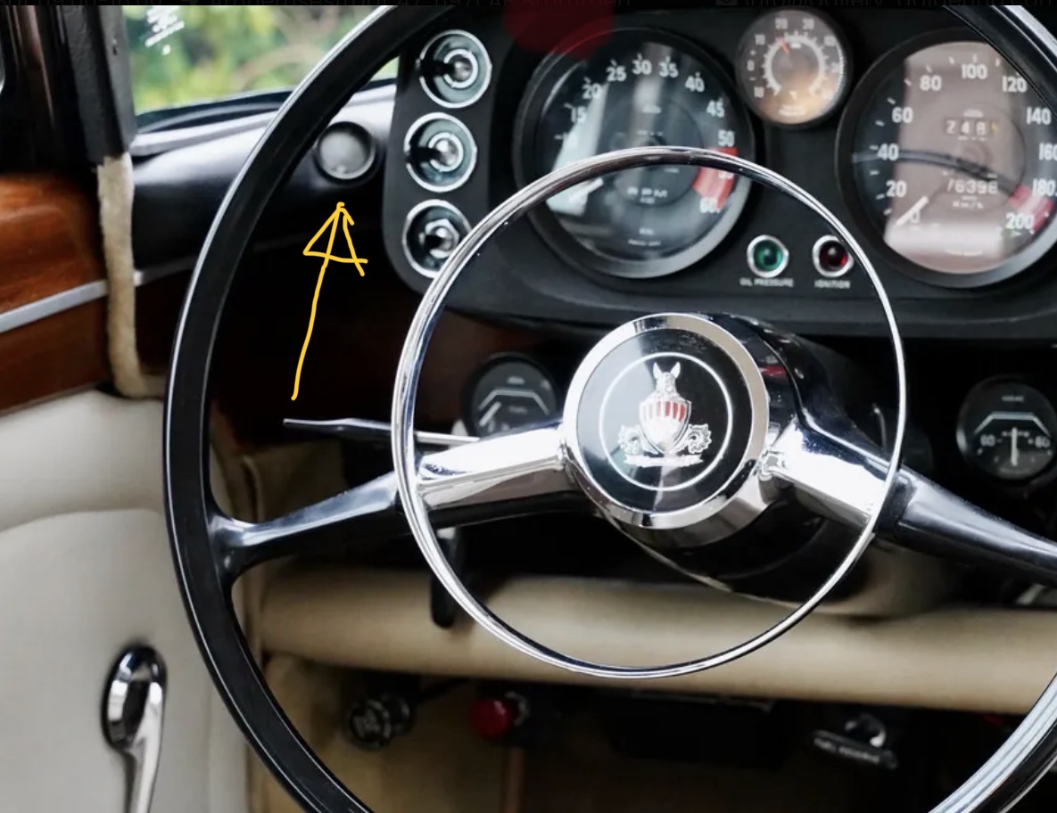

Does anyone know what car or delivery van the airflow vents originated?
Dan,
Rover P5
1 « J'aime »
Thank you, sir! Very much appreciated.

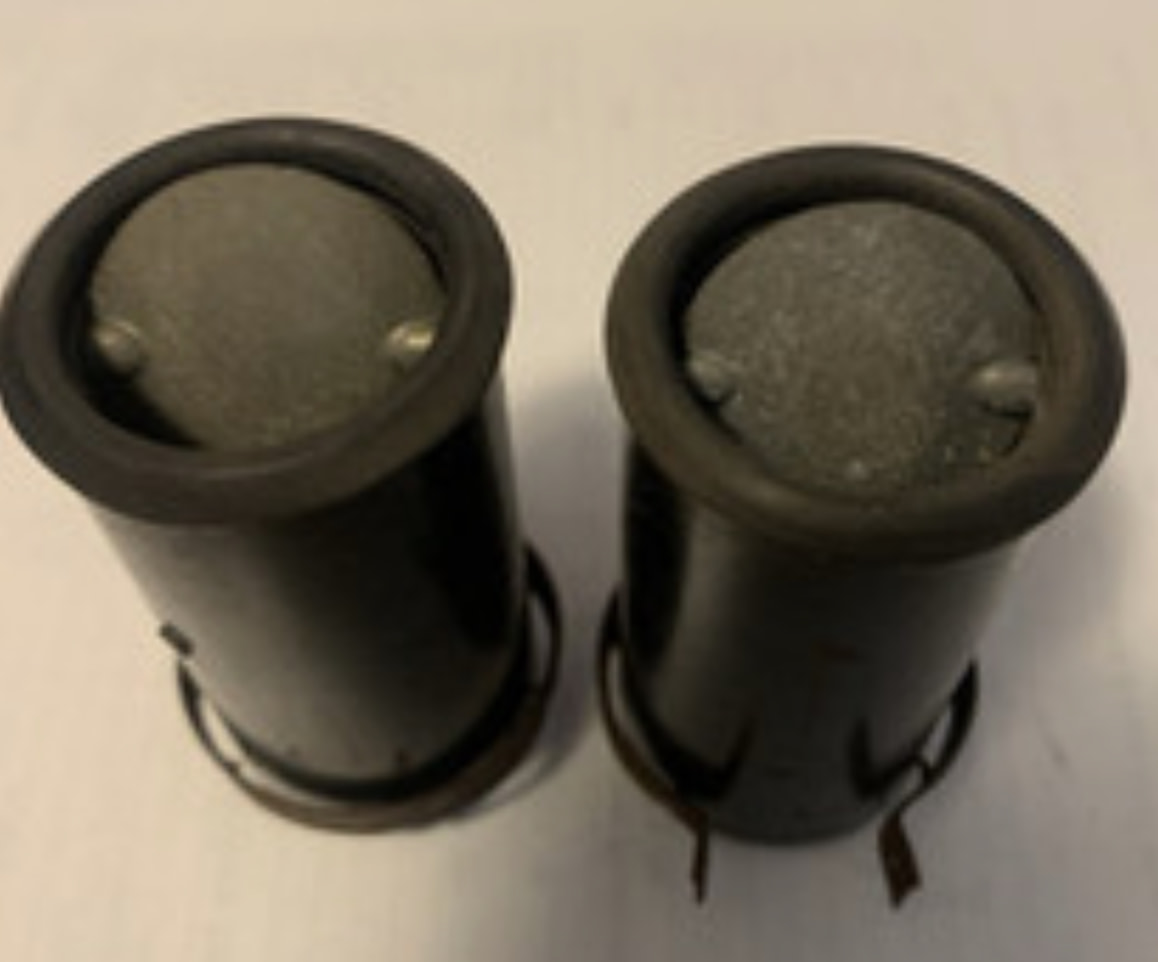

On eBay (UK)
Lotus Elan Face Level Vents - item 177839815567
(Sorry, I was unable to copy and paste a link)
1 « J'aime »
Thanks, crossing my fingers he will ship to the states.
JB
1 « J'aime »
Thanks for the help. My vent has been purchased!

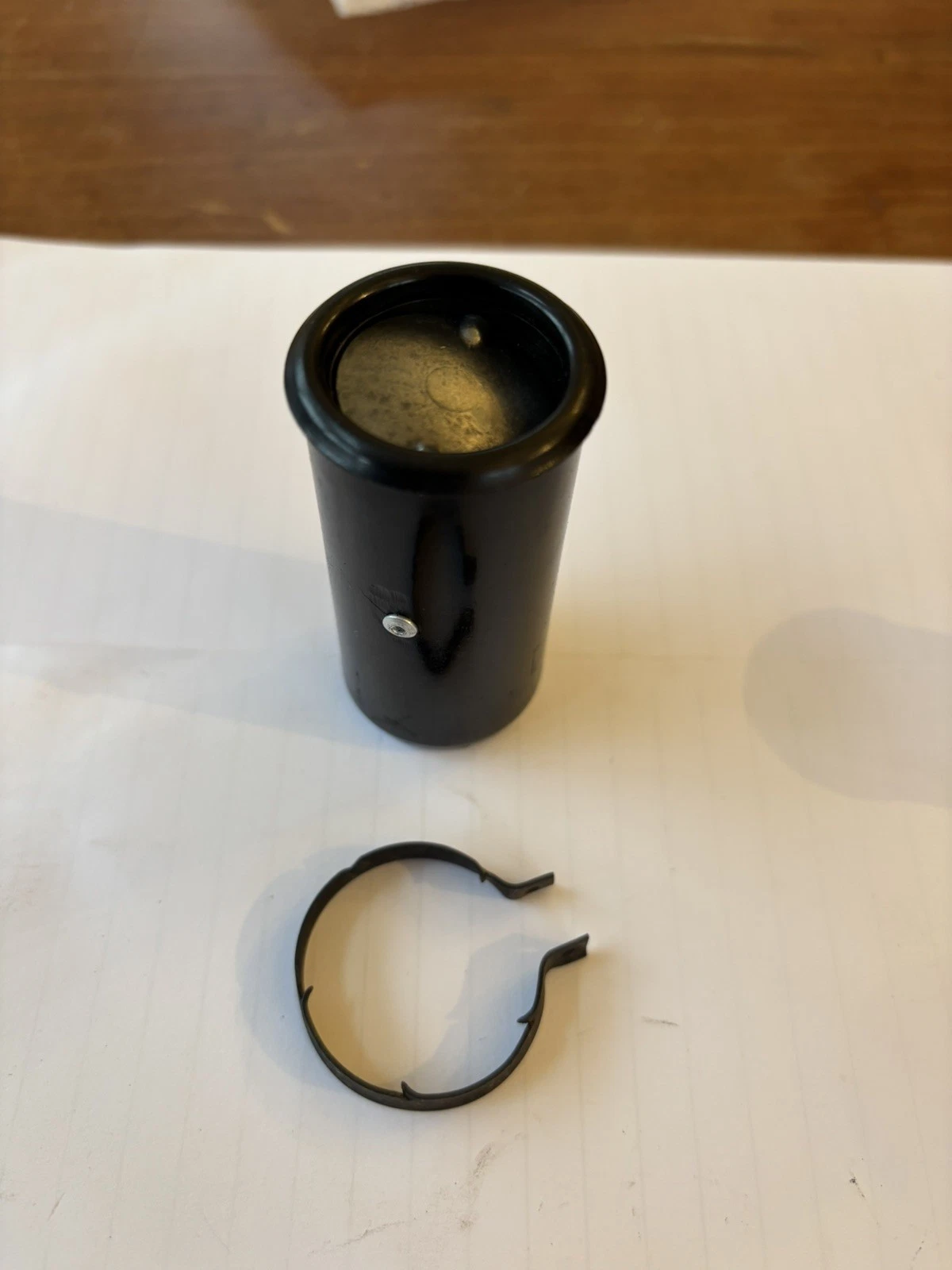

A question on the clips shown with the vents:
Never seen the clips before, were they supplied/installed by Lotus? & if yes, does anyone have a source for them?
The vents are a tight fit (i.e. interfere) at the rear & tend to push out the dash, I ended up using a couple of tie wraps to retain them…
I’m pretty sure my vents have the little clips but it’s possible that I gave up with them. I do remember that they were very difficult to fit because the little barbs dig into the plastic of the vents. This makes them hard to slide up the tube to the dashboard valance. And once there you have to tighten up the tiny nut/bolt clamp. Lying on your back in the footwell, it’s close to impossible, or was in my S4 at least.
On the other hand, if the heater hose is long enough you can push it over the vent tube right up to the dashboard valance without too much difficulty. I found this to be quite sufficient to hold the vents firmly in place. They’re mostly cosmetic anyway! :slight_smile:
Nick
2 « J'aime »
I am sure the clips were used. but as pointed out very hard to fit and often forgotten when trying to remove resulting in chipped rims…
