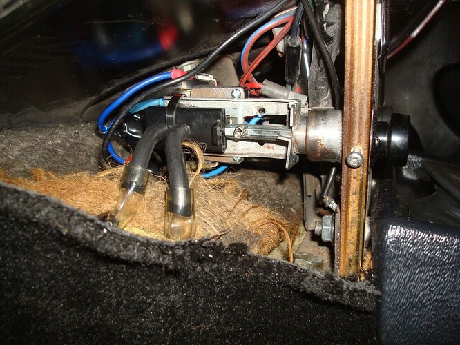

Kurt, I made one using a Corvette headlight switch. It’s a basic push to hold vacuum/pull to release switch. Here’s a link to one:
ebay.com/itm/NEW-1968-1982-C … f0&vxp=mtr
Here’s a picture of how basically I made mine. I used the bracket, shaft and knob from a Ford Zodiac headlight switch. I turned down the fat end of the Corvette switch to fit inside the hex shaft and ‘tied’ them together with the clip.
Mine has the microswitches attached and I have pics of that, if you wish.
I got lucky finding the Zodiac switch. The knob and its attachment to the hex shaft is the same as an Elan, but I’m sure you can fabricate something similar.
Let me know if you want the full story on my switch.

Phil, Stu’s got it right. This is the very crude final version of my switch. It works very well and I made it so the Corvette vacuum switch can be replaced, if needed. Since the installation, I’ve fixed the hose arrangement you see now to use the 90 degree pieces that would be OEM, to allow the under dash trim piece to fit better.
The first pic is the backside of the oem setup. The vacuum switch is unique because it has a ‘dorsal fin’ on the slider, with a small plastic piece attached to work the microswitches. My coathanger arrangement replicates that.
The Corvette switch is screwed to the bracket on the front half and tie wrapped on the back half, with a spacer under the switch to keep it from wobbling.
Hope this helps.
Greg Z
