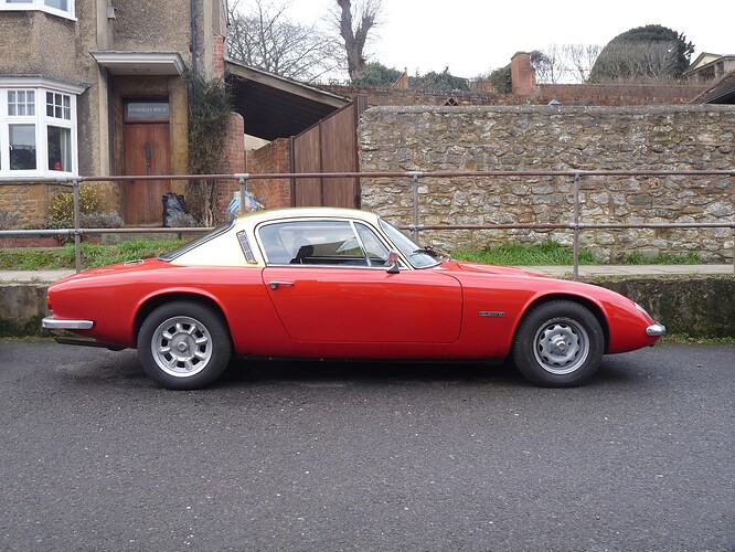

I was running 175/70x14 on Spyder alloys, but have now gone to 175/65x14s as they were rubbing slightly at full bump compression and at full lock. All is OK now. Rolling radius is pretty much standard for the original, but now the side walls are stiffer - closer to the stiffness of the original 13" tyres. Modern 13" tyres (apparently - but open for debate) have much less stiff sidewalls than in period, making the handling a little soggy unless you pump up the pressure.
I attach a little experiment I did a while back with an old 165 Goodyear G800 on a Lotus steel rim vs the modern Spyder wheel. Make up your own minds as to the ‘rightness’ of the look!
Jeremy
