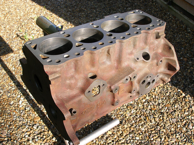

Here’s a link to the burton site of the new TC blocks. Page through the pics, it should give you an idea of where the hole is,
burtonpower.com/genuine-for … fl105.html
May help.
Some blocks have a drilling as per Leslies photo with a core plug that you can fit a short dipstick tube into. Some blocks didn’t have the drilling : some early Escort Twincams (and therefore some Works Twincams) didn’t and a brazed tube went directly into one of the wings in the big capacity sumps that proper Escort Twincams have (as opposed to a standard capacity rear bowl sump).

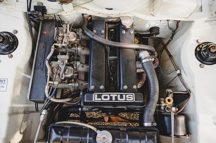

To note, just in case you aren’t aware the Twincam Escorts also had unusual engine mounts to pull the engine over at a slightly awkward looking angle to get the air filter box to clear the inner wing.
The engine also had a stabiliser bracket that joined to the bulkhead from the rear of the engine.
I haven’t done it but do know that original Twincam engines in Mk1 Escorts are “cranked” over.
That doesn’t make any difference to your dipstick tube, but just thought I’d mention it.

Have a feeling that sadly this one doesn’t have a core plug fitted so will need drilling :unamused:

Some blocks have the casting shape shown in Leslie’s photograph above but without the hole drilled but drilling is fairly easy providing you get the angle dead on, and some earlier blocks have strengthening ribs there so drilling is not as straight forward and you wouldn’t be drilling through a suitable preformed cast shape.

Not sure if you’ve seen what I’m referring to before, but see photo below - shows the engine pulled over (to give clearance for the Works airbox in this instance but it’s the same with the original Ford air filter arrangement) and the stabiliser bracket to the bulkhead at the back to the right.
If you want to run filters (I’d never run an engine without any) I think this is the only way to do it properly even if it seems like a bodge!
I don’t know if that car has a World Cup crossmember or not though. My understanding of standard World Cup Crossmembers and mounts is that the engine is not cranked over so if it has it must have some modifications to pull it over (are these the mounts referred to as “Mexico ones”?).

I’ve just checked the block and there isn’t a core plug :unamused:
but there is the flat on the casting to the top face and there’s a form of casting to the sump side that follows the form for the dipstick
Had a quick measure and the hole will need to be approx 75mm deep to go straight through the casting at the correct angle
Hmmm this is going to be interesting :unamused:
