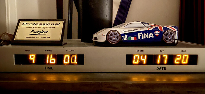

My dad had a PhD in psychology, and a JD too (he got into forensic psychology back before there were integrated degree-programs for it) and he was enough of an OCD-engineer-type* that he would have perfectly related to the story of your hinges’ resistance. He once fretted about his digital clock that ran off the signals from the US atomic clock being inaccurate due to the delay of the radio signal reaching it! I countered that the amount of delay was inconsequential for any practical purpose that he could possibly have, and he smirked a little and said that while he agreed intellectually, his personal quirks still made him fret about it! :laughing:

Your dad was right about the atomic clock delay but IF he had gotten a GPS satellite clock instead, at 10x the price, it would lock onto 8-12 satellites at once and calculate the time more accurately, within 500 nano-seconds. How do I know? I had to have one (4 actually)
