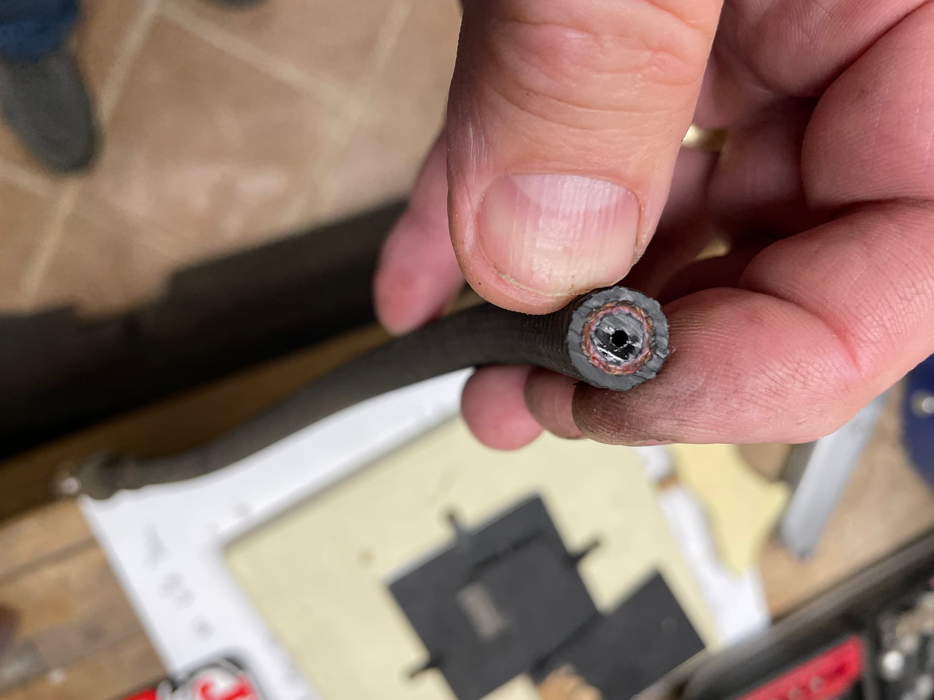

One more post to check for old rubber brake hoses! I had an intermittent issue with what appeared to be calipers seizing, the pads got so hot that they were smoking.
I rebuilt the calipers, but I noticed when I went to bleed my brakes with a power bleeder I would have to press the brake pedal to get the brake fluid to push out the bleeders. The power bleeder would not push brake fluid through, even at 20psi! Changed the hoses for new ones & no issues bleeding or the calipers getting warm again. Fuel consumption has gone down noticeably as well.
I cut through the hoses after to inspect them, note the internal diameter is very small:
