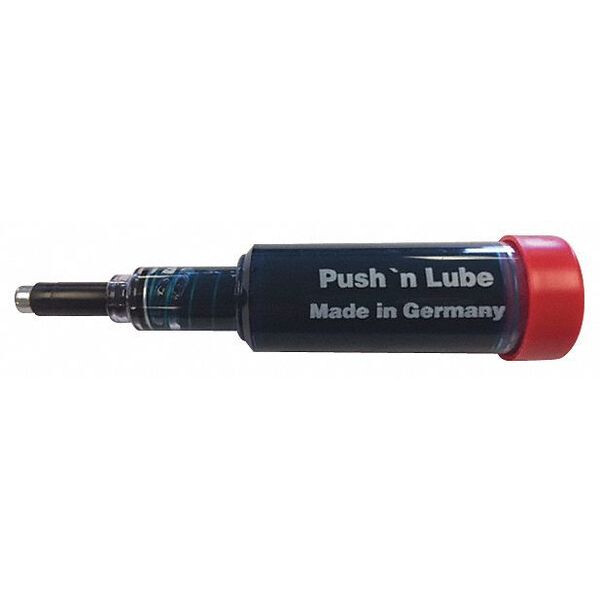

On my plus 2 i have a zerk fitted to the top bolt and whenever I oil the trunnions I give the rack a couple shots of redline 75w90 oil with one of these:
