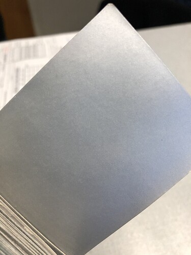

Sorry do not know the code but apparently this is a good match
