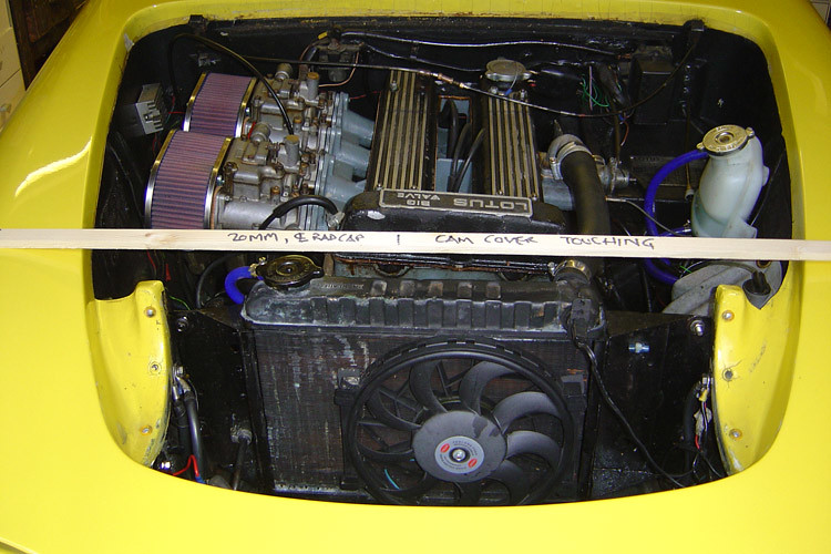

On my Sprint I measured the clearance between cam cover and bonnet with the old chassis before starting any removals. Then fitted the Spyder chassis and found that I needed to put half an inch of packing at the front end, tapering back to nothing at the rear end in order to get things back to where they were. I then decided to add an extra quarter inch at the front, as the rad had occasionally touched the bonnet. These were never precision-made vehicles! :smiling_imp:

This shows you what to do next time! The piece of timber was checked for straightness and placed across the tops of the front wings. It was checked for straightness again when the new chassis went in(!)
