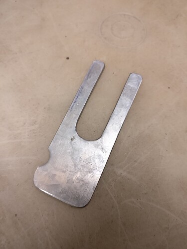

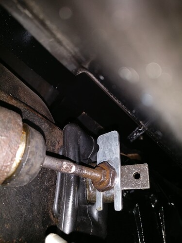

What is the existing free play of the pushrod between the slave and the clutch arm? The book calls for 1/8" or 3MM. Any more than that makes clutch disengagement difficult under the best of conditions. The adjuster nut and locknut allow for the correct free play. Each part of the clutch assembly from the pressure plate to the pedal fulcrum wears to some extent, and all of that sloppy wear means reduced clutch travel.
My Workshop Manual gives the clearance as 0.08" or 2.03mm
I made a setting tool which makes adjusting the clearance somewhat easier than using feeler gauges while trying to hold the pushrod and turn the adjuster nut at the same time. 14 gauge steel sheet is exactly the right thickness (2.03mm)
Roger
5 „Gefällt mir“
Thank you for the correction and posting a photo of your tool. That’s brilliant!
Roger
Good tool shout, thanks
Tony
