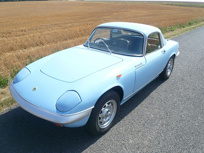

I am not sure about attaching the body, but my car had definitely, from new, had the seatbelt reels attached there. As mentioned, the fixing point is basically right between the shoulders making it quite awkward, so for S4 it was moved outboard with brackets.
Unfortunately I don’t have a better photo, but if you look inside the car, the white plastic box behind the driver’s seat is in fact the original inertia reel (now removed). As the photo shows, this really does mean that the belt wraps around your neck…
