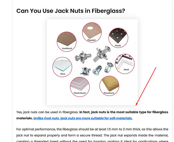

Just reading through this - How to Choose Rivet Nuts for Fiberglass? - Rivetfix Rivet Nuts and towards the bottom !! Its never ending :slight_smile:

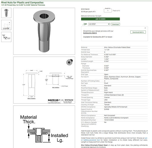

Standard rivet nuts are great for sheet metal. There are better options for fibreglass such as chloroprene well nuts, adhesive bonded nuts and composite-specific rivet nuts such as the above or this SKU from McMaster

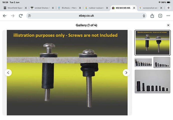

I have used rivnuts on my +2 bulkhead to connect non standard brackets for washer bottles and coil packs, but I have also used Wellnuts which perhaps are a bit kinder to thin fibreglass
My series 1 Elise is held together by Wellnuts as standard and I have used them on my motor home to replace exterior door catches with great success. For holding things like washer bottles etc they would be ideal and much better than rivnuts.
I used Rawlnuts/Wellnuts on a few areas on my S4. Things like fusebox to bulkhead, repeater lamps to the wings, relays to the inner wings, harness P-clips, etc. I even found some that had the same thread as that used on the front Lotus badge.

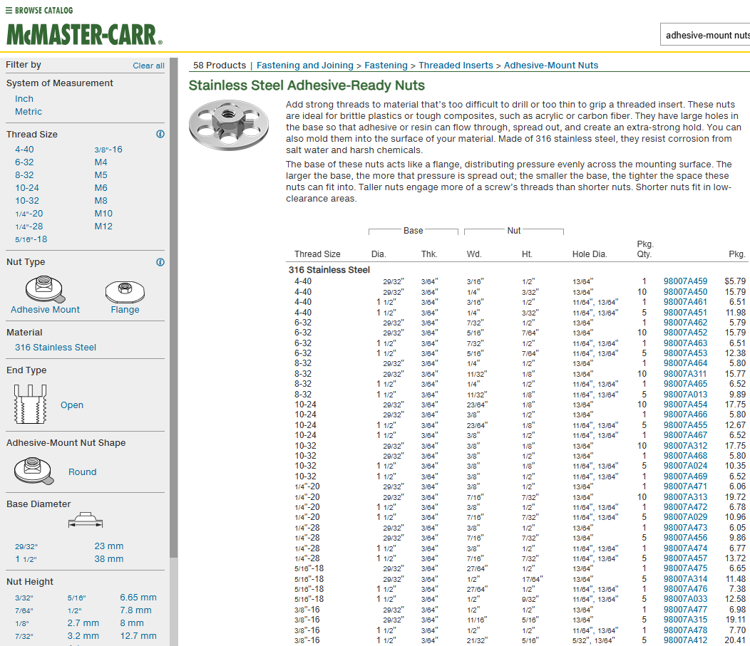

Could not find what you meant on carbuilder ( unless you meant these - Nut Plates – Car Builder Solutions) - or is this the sort of thing you meant - Master-Plate bonding studs for composites. My engine bay is a bit like Swiss cheese with all the modifications to it over the years So long term I hope to sort it out and may end up putting a new matt of fibreglass over the bad portions :slight_smile: and then painting over. Or I may not bother , I’ll see.
Go into car builder and use drop down menu - one of them is ?,?, fixings. Go to that folder and I think the first item shown are glue/ glass in fixings. I believe the are used in the aircraft industry.
Hope that helps
found them - thanks - Big Head Fixing – Car Builder Solutions
For anybody on this side of the atlantic, McMaster also stocks these and a similar product with a stud in place of the nut.
