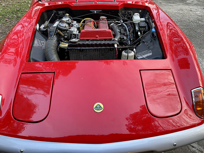

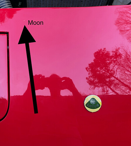

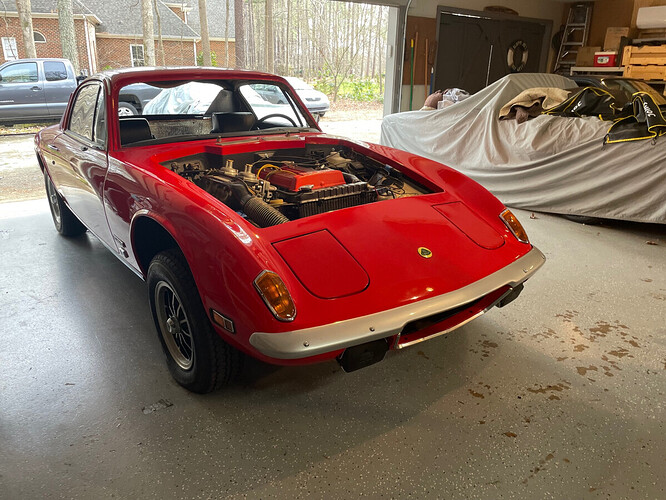

Well these recommendations have gone very well. The paint is far from perfect on this car, however I just wished to make it more presentable. So I got some "Mothers’ Clay in a kit form, that seemed to work very nicely on the finish. I also selected a Menzerna medium cut polish, and wax in one bottle. I did all the work by hand, no machine. The combination of the two brought up the finish very nicely. It still needs more work and effort but here is how things currently appear.
(If you look closely at the car photos, you can see the reflection the moon and an aircraft- which was kinda fun)
Made up for you. Nothing better than a nice shiney car.
