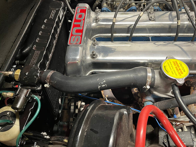

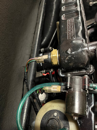

Just completed refreshing the cooling system including new hoses and upgraded radiator. The radiator had the otter switch replaced with Brass fan switch which activates at 82°C, deactivates at 72°C. M22 x 1.5 thread. The radiator filler is no longer on the radiator with the filler now replaced by the Coolermaster Thermostat housing which includes the filler.
However having connected it all up using the original wires of the old otter unit the fan doesn’t want to kick in. If you join the wires together the fan does work ok. Am I missing something???
If the fan goes when you join the wires to the switch then it looks like your switch is faulty

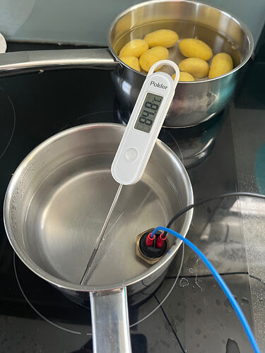

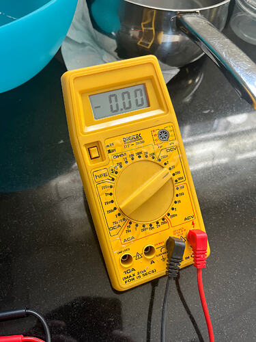

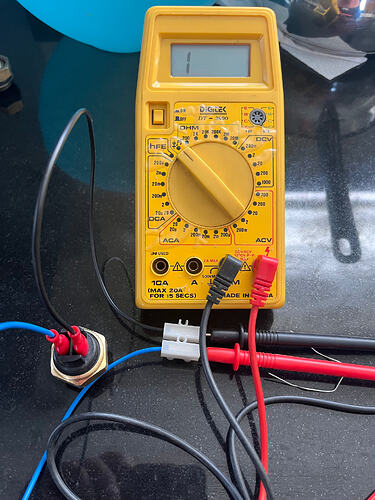

Here’s my heath robinson test rig using multimeter but still no joy, is this the correct process. Tried setting meter just to beep on complete circuit and my usual 12v test.
If your meter beeps when you put the probes together, but no beep across the thermoswitch contacts above the specified temperature, suggests the switch is indeed duff..Tony

If the switch is working a multimeter and thermal bath will show it. If that’s the case then you can set up the needed relay when you install it in the car. If not you need a new switch
First off with your set up does the meter beep when the two wires are put together - if so that is correct, if not then you need to set the meter up properly so it does.
Then connect up the thermostat switch and heat it up in the pan of water. If the water gets to 100 degrees (I.e. boiling) and the meter doesn’t beep then the switch is faulty.
For the test a relay is not needed as you are testing for continuity.
