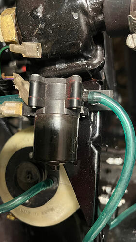

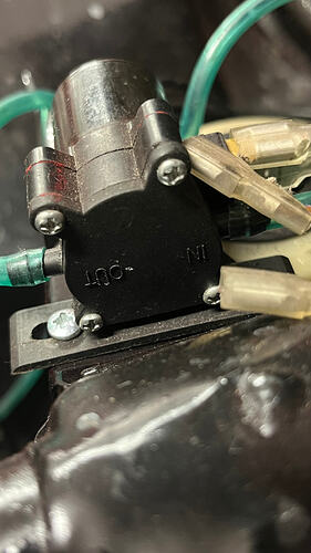

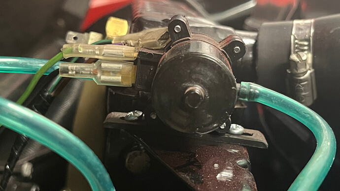

Will take a look and get back to you :+1:
Can’t find any manufacturer logo, possibly on the mounting bracket or underside .

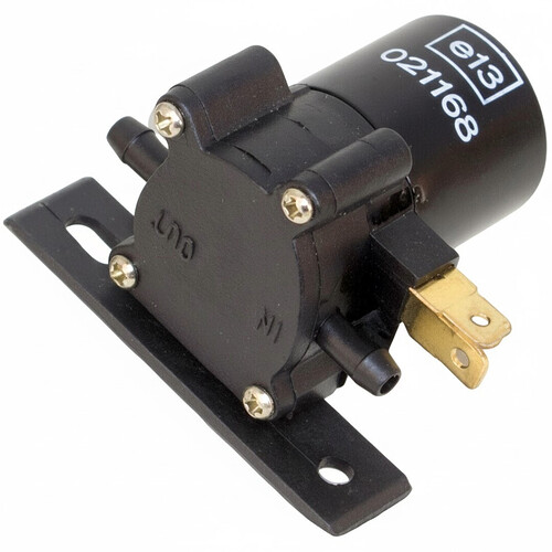

However car builder solutions have similar on their site

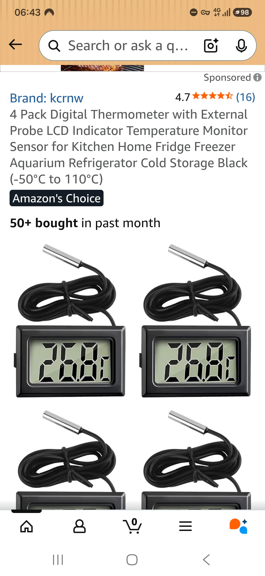

I had a period a while back where I was worried about the temperature of the rover V8 engine in my triumph stag. Notorious for overheating. I didn’t trust the 50 yo sensor so used one of these for a while to get a correlation. Cheap as chips. I was able to place the sensor very close to the water system and watch the temp change real time with good resolution. It was quite instructive to see how it changed under different running conditions and how the fan influenced temp. It also showed that the sensor was around 10 degrees out.
