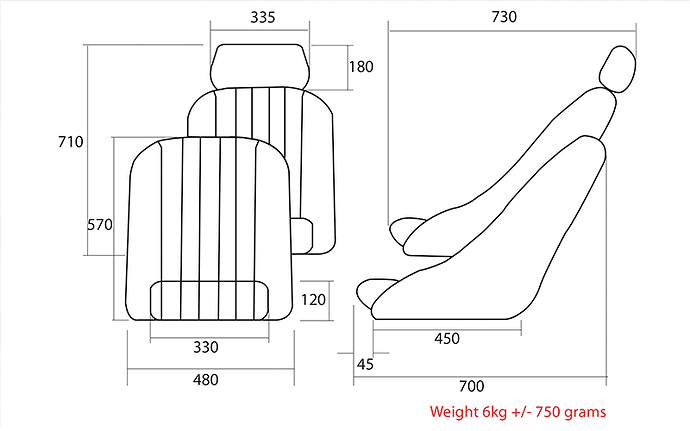

To put it in a nut shell I am considering fitting new seats to my Elan Sprint but have several queries that hopefully someone can answer.
The seats I propose to fit are Cobra Classic CS or RS style seat http://www.cobraseats.com/_Classic
Size wise I think they will just go in. I have contacted Cobra and several suppliers and it comes as no surprise that a specific sub frame/seat runner assembly is not available for the Elan.
Has anyone fitted this type of seat recently using the Cobra supplied runners?
If so what if any modifications were required?

We have a Classic in the Mini- it is not for anything other than a “quite skinny mature Gentleman”, the bit your arse goes in is much narrower than the Elan seats, the side bolsters are quite thick, come much further forward then Elan seats and the Classic grips your hips with two steel tubes beneath the padding, not at all comfortable for me!

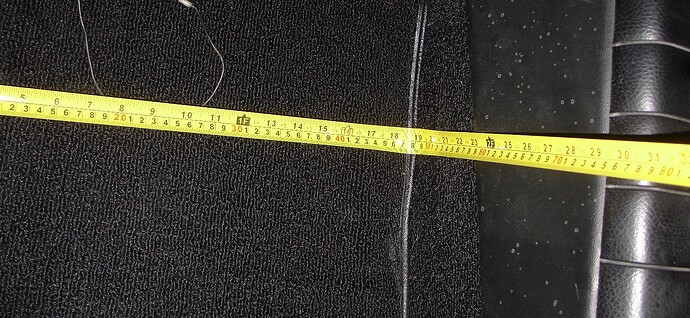

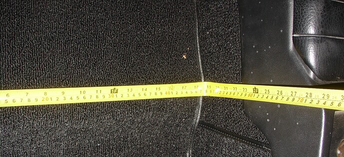

The Elan seat is 470mm wide and completely fills the gap twixt sill and tunnel, the Cobra is 480mm wide, so might not even squeeze in (bear in mind the hidden steel side frame).
I think that the modern seats which Elan folks have fitted are the sort used in Caterhams.

Thanks for taking the time to do the measuring. I have measured between the tunnel and sill and it is 470mm and a bit. I thought the bit might be enough. I am asking the questions from you knowledgeable people before spending any cash :wink:

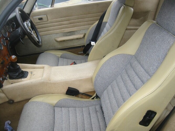

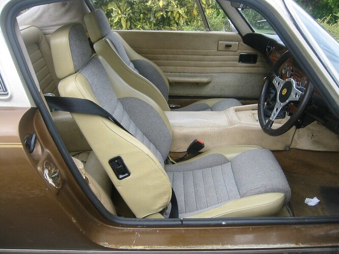

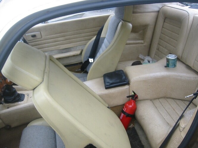

Hi further on the seat theme . I’m sure this will horrify some members but I aim to replace the seats in my +2 ,there I’ve said it! The trim is completely shot which I aim to have reupholstered however the standard seats are to big for the car and are complete rubbish(sorry) . Has anybody utilised seats from another car MX5, Smart etc.
John…
Salut Jaybee
If you search the forum you’ll find lots of references and some photos of MX-5 seats - lots are happy with them and they are probably the easiest and cheapest to find and in a wide choice of materials. Spyder apparently use XJS seats but they really are a tight squeeze - I tried them for size. I was going to fit X1/9 seats (old 1300 model) and they looked a good fit but I found some +2 fed seats - I was after a neck/head rest. I’ve seen (in photos) Elite/Eclat seats in a +2 and they look a good match style-wise if you’re also after headrests (but be careful they might make access to the back seats (more) difficult). Think somebody fitted MGB seats, too. Then there are all the new offerings - just check the width.
