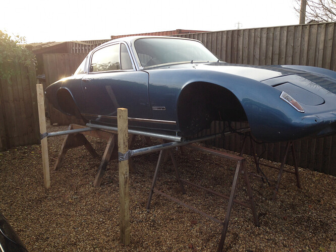

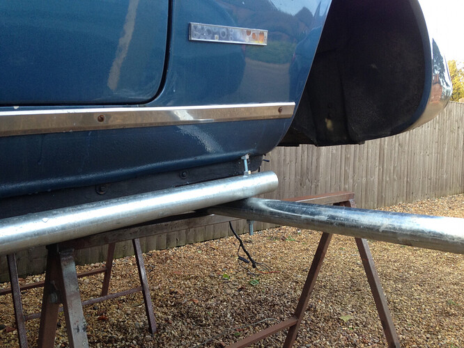

Here’s how I do it, see pic.
Whatever about removing the engine and gearbox first, there is no need or advantage in removing the final drive beforehand.
And I see no sense at all in turning the chassis sideways ! :slight_smile:
Why remove the engine and gearbox first Norman, much easier once the body has been lifted? If you are only raising the body about 3’, you can then roll out the chassis and then work on it.

When I removed the body of (2 of) mine, I simply(?) unbolted/disconnected as needed then heaved, grunted and lifted until I could get a sawhorse under the front, lifted the back, more heaving and grunting and wiggled the rear sideways onto another sawhorse…
I must have been mad, doing it on my own and it was rude and crude but since I was re-doing the paintwork as well, any scratches would have been remedied. I suppose I could have had the whole thing go, literally, sideways on me but to paraphrase “God looks after fools and drunkards and Lotus owners”…
Bottom line, it can be done by one, two is better, three would be ideal, four is more than needed and any more than that is a party.
As noted though, the BEST thing to do is leave (almost) all the mechanicals in situ before removing the body…I believe I removed the carbs first (Webers as they stick out a little more) because working on the engine/box/diff etc with the body off, is a wonderful experience
So, to sum up, 3-4 able bodies, a couple of sawhorses, a case of beer and 1 hour should see it all done.

I removed the body with scaffolding and pulleys similar to Foxie’s photo above. Biggest issue was figuring out a method to attach the pulley lines to the body. I used the Plus 2 jacking points with two pieces of 1 1/2” aluminum square tubing down each rocker, and threaded rod inserted in the jack holes. Was a bit awkward until the body was high enough to allow two tubing pieces to be inserted crossways above the backbone to prevent bending the jacking points. Used a combination of jacks to apply vertical force to the jacking points, but it was not ideal execution.
Note the previous owner had already replaced the rocker rails; absolutely do not assume the jacking points and rails are solid, and replace as required if relying on them.

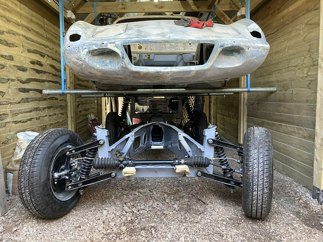

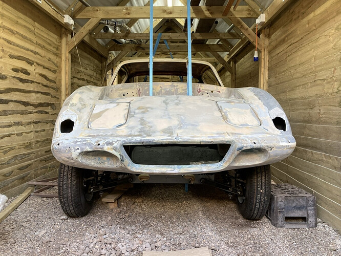

I have recently trial fitted the body to chassis several times following extensive repair work. I did this single handed using ratchet straps attached to some roof beams, see pics.
This is cheap controllable and safe. Once the body was lowered onto blocks on the chassis I repositioned the straps through the rear turrets and round a beam in the engine bay. Final lowering is by the hydraulic jacks.
Dave
Thanks Dave, the pictures are helpful and interesting I have similar space, altho height maybe an issue but timber supports look feasible and also it doesn’t look as tho lifting points are too critical? Is it best to leave doors on/off? And do I need to replace sill reinforecments first before lifting - I’m assuming they’re shot?
