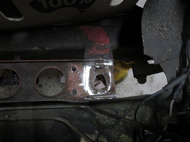

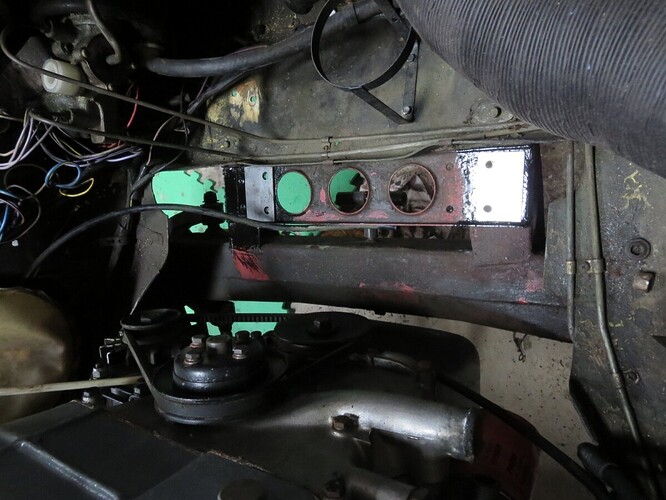

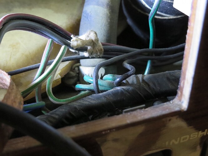

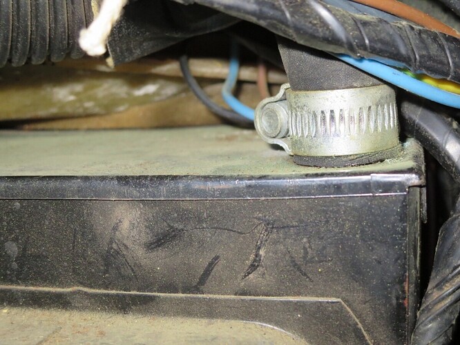

Some Pictures of some rectification and frustration.
Since when did using cheap iron become used as a shim!

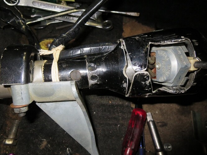

Interesting Steering Column Mod
A heater hose clamps playing hide and seek

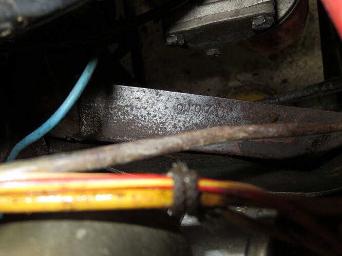

Today I finished reconditioning a reconditioned steering rack… I bought a rack that was sold as new reconditioned, I finished up making one out to the two racks and then reconditioned it :angry: by replacing the pinion and straightening the reworked rack ( bent by 2 mm)

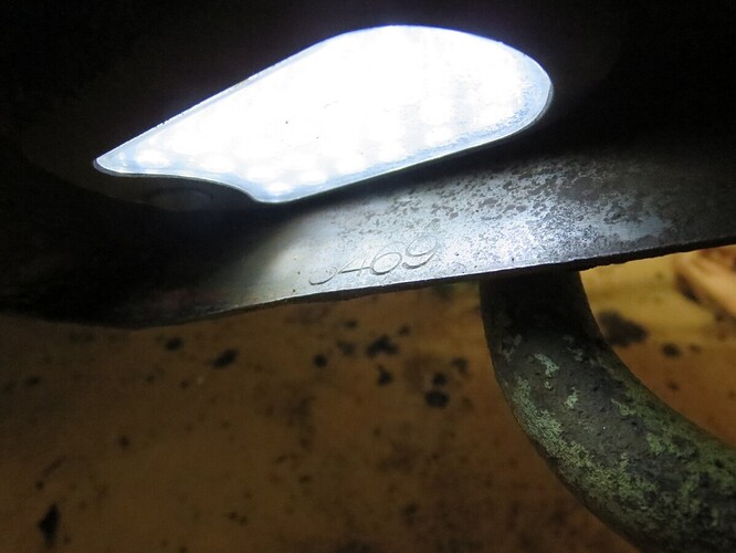

I also located the chassis serial number and the chassis number, and after communication with Tim at the Sprint register have just added more fuel to the chassis numbering conundrum!
I just need to figure out which one is relevant to the Parts Book! as the ID plate is 7100000335G

A visit from the Prince of darkness himself.
While endeavoring to sort why the High beam light wasn’t working, I found the bulb was OK however while reinstalling the tacho , connected the earth lead to the mount stud and as it as in the way flipped it over only to discover it contacted one of the white wires and doing it up made contact and when I put the ignition on the prince appeared. Amazing how 2" of wire can produce that much smoke!
In the end all is well the Tacho still works and all the wire damage sorted with the correct colour and connectors.
Bonus the high beam light now works.

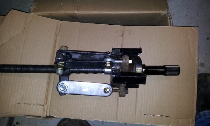

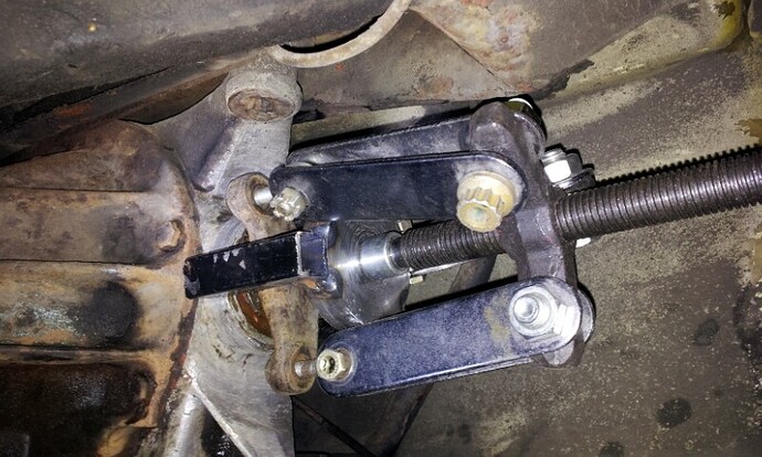

Another week and another few late nights. The CV’s are in but before I got that far I had spotted an oil leak from the drive flanges. While I have the drives out and calipers of I decided to change the seals. never ends does it.
I made a puller to remove them and it worked very well.
I can make a drawing if people are interested.
The old seals were so hard they were brittle and almost fell out. well worth the effort, and I changed the bearings as well. odly I had to buy those as they were not amongst the spares!!

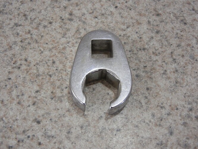

Best tool for flange nuts is a snap-on crows foot.

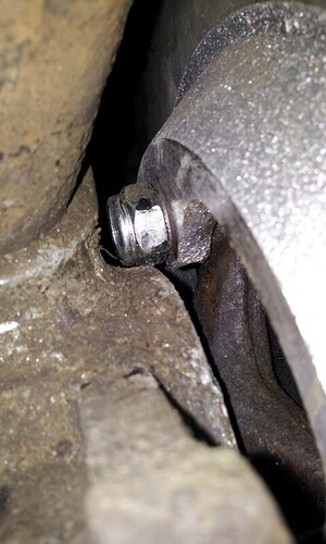

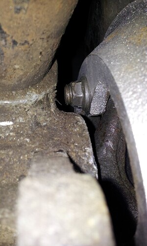

CV’s now in and I must say that was no mean feat.
They are right on their travel limit and you can feel the bals in the joint binding at the end of their travel.
The new Mick Miller CV’s that I fitted have 11/16" AF nuts which fouled the strut housing. I replaced them with a reduced AF nut ( Pno. MS21042-7) that’s only 1/2" AF Much easier to do up and they are reusable.

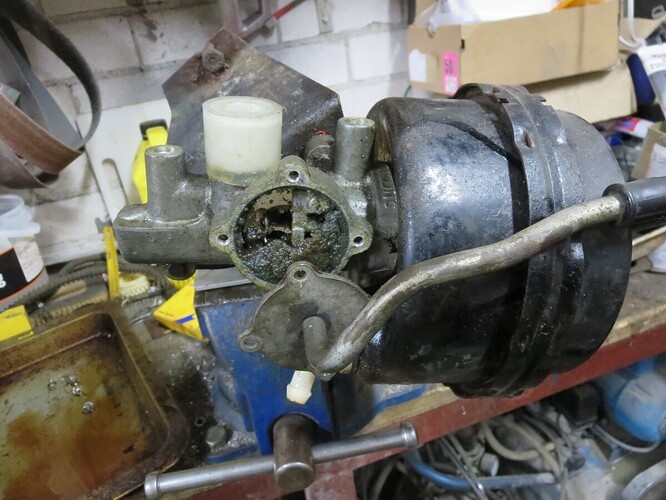

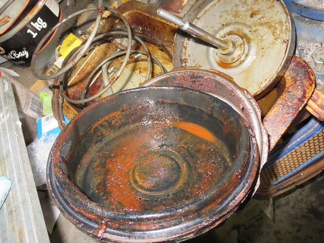

Given I have the brakes in pieces I removed the booster, just as well its a mess inside.
I found this link to overhauling the booster and what appears to be a service bulletin the change from the MK2A to MK2B on a Volvo P1800 website.
volvo1800pictures.com/document/G … d%202B.pdf

Well done you for taking on the booster as a DIY project. It’s not particularly difficult. The hardest part is finding the ball bearing when it pops out and rolls under the nearest piece of furniture. Kits available from UK (and expensive for the 2B type) and if you need it re sleeved in stainless like I did, Burt Brothers at Villawood will gladly relieve you of $300 for the privilege! But a servo resleeved in stainless will outlast the car and its owner.
Robert
Hi Robert.
Wow thanks for the heads up on the ball I didn’t realise there was one, but now I know I will look for it in the bin I placed underneath to catch what ever come out of the spheres!
Stokies’s in Miranda (Weldon brake and clutch) I will get to do the sleeve and and they can supply a kit so they tell me, but I will wait and see on that. I will take the whole unit to them today so then get the correct bits.
as I am aware there is 3 versions of the one case.
I am more than happy to have a go at the booster myself however I may finish getting Stokies’s to do it.

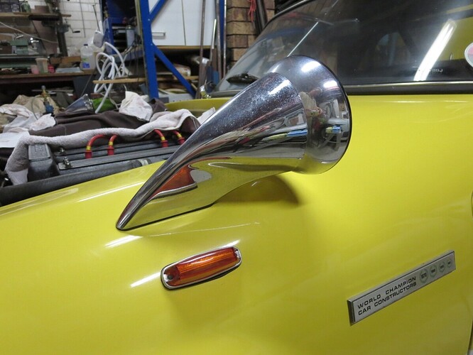

The Car had external mirrors next the side repeaters, I am told that was a requirement in the UK is this correct.
