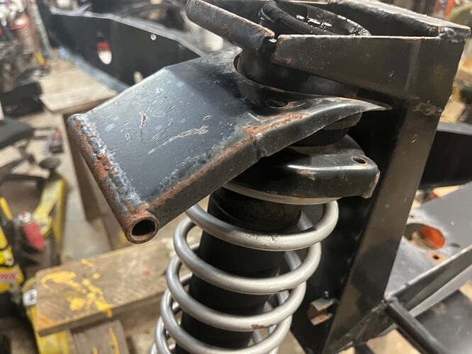

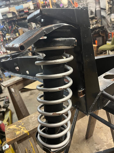

Rear piece between chassis turret and lotocone
ideas what please
That’s the bracket for the seat belt shoulder anchor. It should line up with a hole in the body facing towards the front.

The lotocone sits below it and the bolts go through the lotocone and it to the chassis. There is a threaded insert that screws into the front with a square head and bolt hole in its side. This sticks through the hole in body and the seat belt bolt screws into it. Simple really :slight_smile:
Yours looks a bit banged up. Still available new (from SJ I think) for a reasonable price.

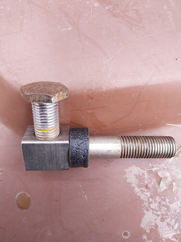

This is the seatbelt attachment bolt that Rohan has referred to. The spacer washer is at the point where the bolt goes through the body and provides a circular surface for a large grommet in the body hole to seal against. This is for attaching a static belt; inertia belt attachment might differ.
「いいね!」 3
confused me, the plate with the arm which sits between cone & chassis holds this square head & seatbelt anchor which goes through hole in body for shoulder belt.
So the plate with the arm is for? As it doesn’t seem worn/used (other than the obvious unnatural curve) there appears to be no wear.
Stresscraxx (post #2 ) has your answer. Your’s has a major bend in it where it bolts to the
turret. Should be flat.
「いいね!」 2
So it anchors through the long tube @ end of plate
Or via threaded square head
Or both
Or i am missing something, come-on brain…work…

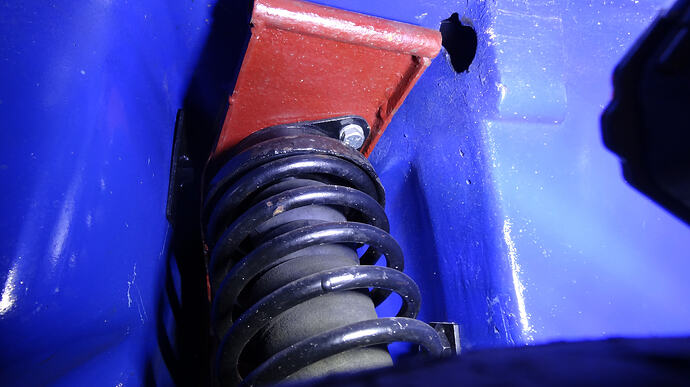

Here’s a picture of it on my S3 and the corresponding hole in the body. I have the Spyder 3 point
belt conversion,
hence, you don’t see the piece that Smo17003 shows.
