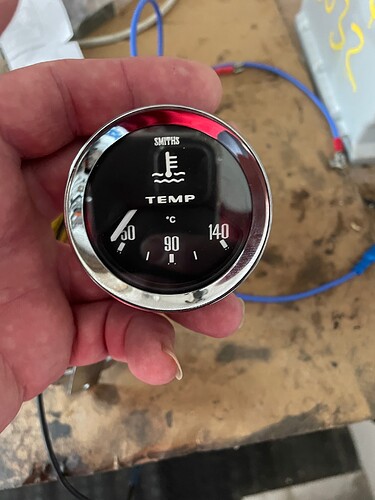

it’s a smiths electronic resistance type with sender just below thermostat housing.
I did contact smiths as the car was like this when I got it (over temp on gauge) but no signs of overheating on car.
I did fit V/Reg to gauge (based on advice from smiths) and it still over read - Far as I know the B terminal is battery +

I even replaced the gauge and sender with a new Smiths Heritage set.

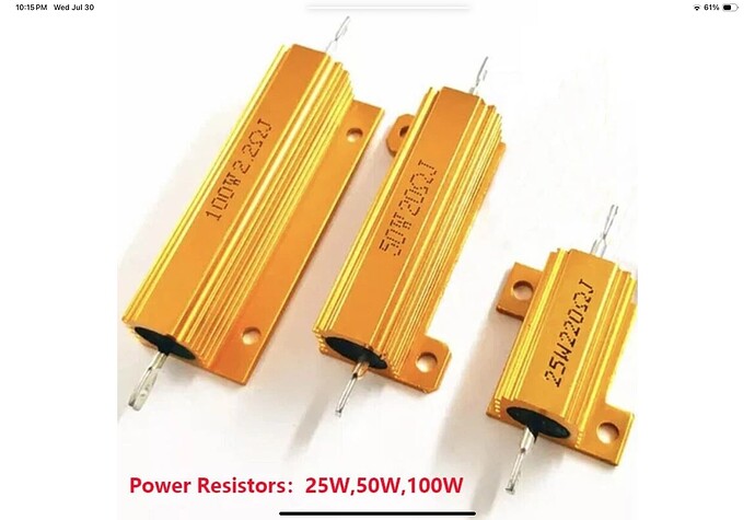

Finally I ended up ‘tuning’ the Heritage gauge with a resistor in series with the sender. I settled on 20 ohms to get the gauge midrange at cruising. The Heritage Gauge has a 90 degree mid-point. I used the same technique with the stock gauge and sender as well; from memory it was about 10 or 12 ohms to get a reasonable gauge reading.
The gauge now matches reasonably to heat gun readings and an icing thermometer placed directly in the coolant next to the sender (I have a cap style thermostat housing).
Way less anxiety, and the gauge now tracks very well with the electric fan coming on and off at idle.
The resistors look like this and are readily available on eBay in various values. Some come with wires that just need crimped-on spade connectors. These ones need wire soldered on.

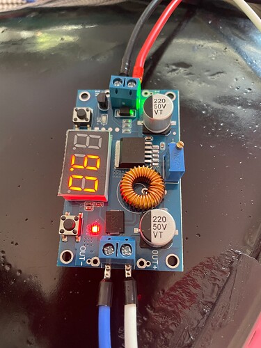

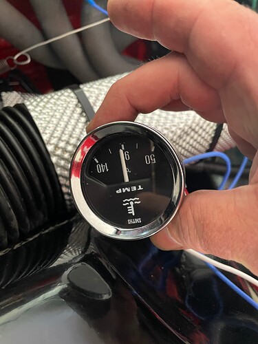

I’ve jerry rigged a unit with a digital VR <5 quid - therefore cheaper than the VR units sold for gauges- it’s also adjustable output as well.
So done testing today and now have a good correlation from the laser measurement and gauge reading. with a gauge feed of 10V
So will wire that into the temperature circuit tmrw and test - but I now know I won’t see the gauge at 130deg with the engine at 95deg ish - as it’s intuitive to worry when your looking at it whilst driving and those niggles don’t help when seeing the needle indicating 120+
