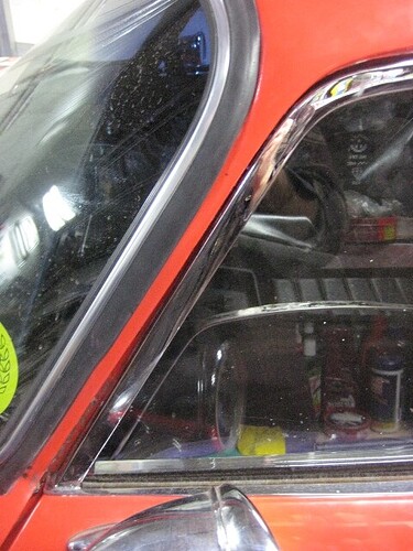

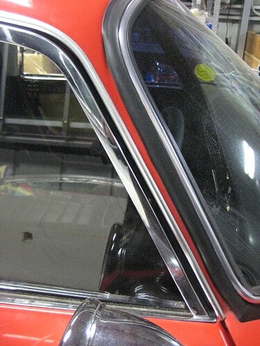

Here are a couple of photos, I took them when it was nearly dark so it’s got the flash in use. I think that is shows the gaps quite nicely but its only the front. A photo of you problem may help folks see what you are talking about and be able to better offer an answer. I am not sure about your Elan but fiberglass moves (heat, cold, etc) over time, a 90 degree angle will close to less than 90 if left long enough unsupported. that probably not be you problem, I don’t know as it would take seeing the coupe and thats not likely.
This door looks like it is to far down but the gap in the crotch makes it so it can’t come up much without altering the body. Its possible to move it a bit and may help some but its likely to be off somewhere else.
Rain gutters have yet to be installed so it shows the true gap.

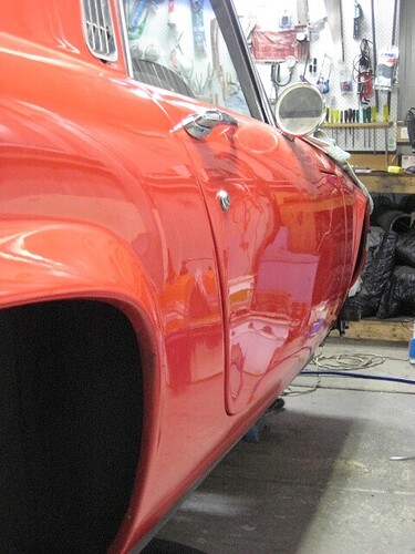

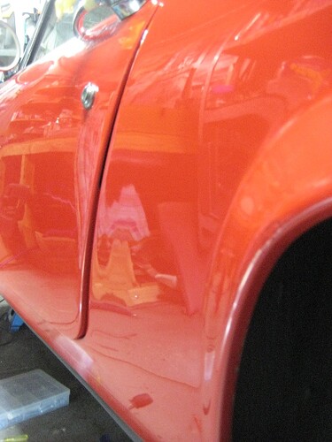

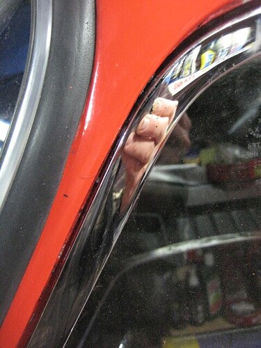

Firstly, thanks to everyone who responded with comments and photos. Much appreciated. I’ve attached some photos of the issue at hand. The first shows the frame to body apex issue followed by where I fiunally ended up. As you can see in the photos the gap between the frame, body and a pillar closes up around the front upper apex, making door adjustment, fit and finish very tricky. At least now the door closes well with clearance all round the frame. I can only assume manufacturing tolerances have conspired against me on this one. Also included some photos showing the RHS and the windscreen fit to the body, which to me looks just right. Anyway, it is what it as and I’ll make the best job of it I can.
